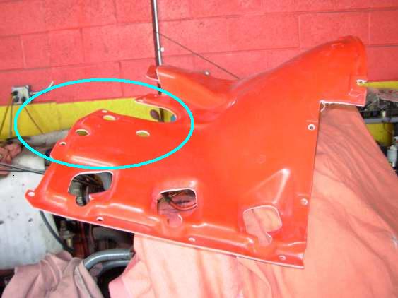

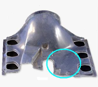

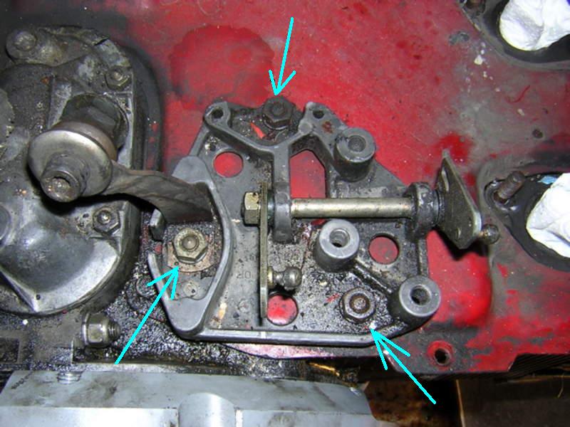

These are the studs I would like to permanently remove.
The first pic shows the plate mounted, the second shows a fan shroud where the studs come through, and the third pic shows a non CIS fan shroud. I do not want to have to drill these three holes in the new shroud if I dont have to - I just want to pull them out if it wont hurt anything.
Thanks!

Like the Ricky Racer #4 said, "Cut them off". I would still try to remove them
or
Better yet .... just use the stock shroud ... It's Red man ... ya know ... Porscheeeze for "S" model .... what more could you ask?
You won't open up a whopping leak as I remember ... they are blind holes into the case for the studs for mounting the accelerator console.
