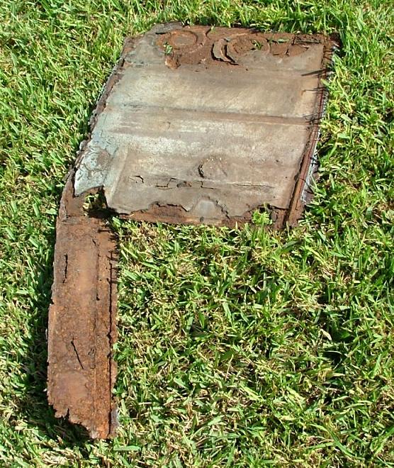

Um, my car had a large rusty hole under each of the seats. There was no wiring
left to speak of. I was surprised the seats did not fall through unto the ground.
This was the largest piece of floor pan left in the car... The "good" part is
from the footwell, the "somewhat rusty" part was under the driver's seat.

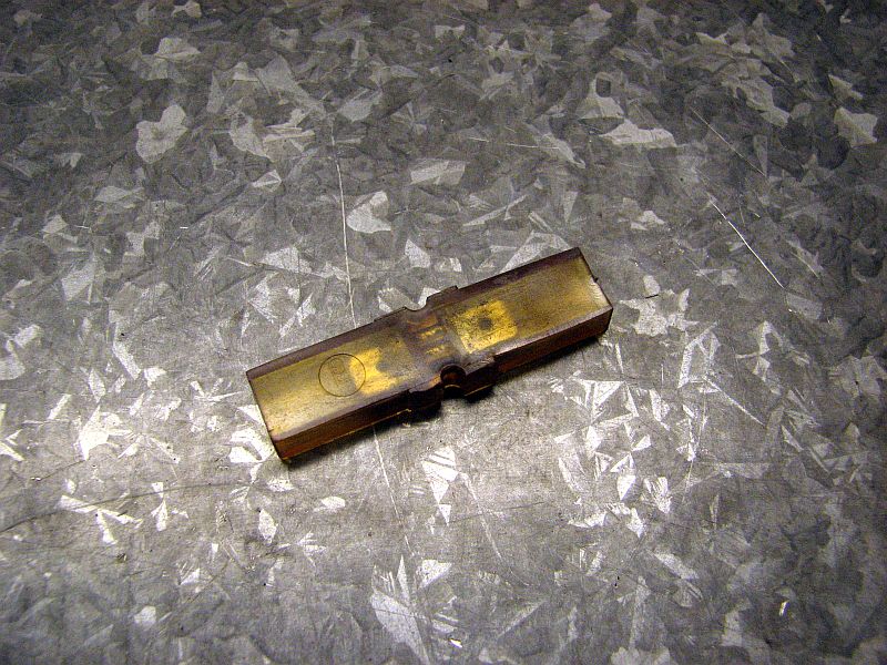

Naw..this is the easy way and I understand the dealerships did it this way, using this double connector. No cutting required and easy to reverse. I have a bunch of them if anyone wants one.

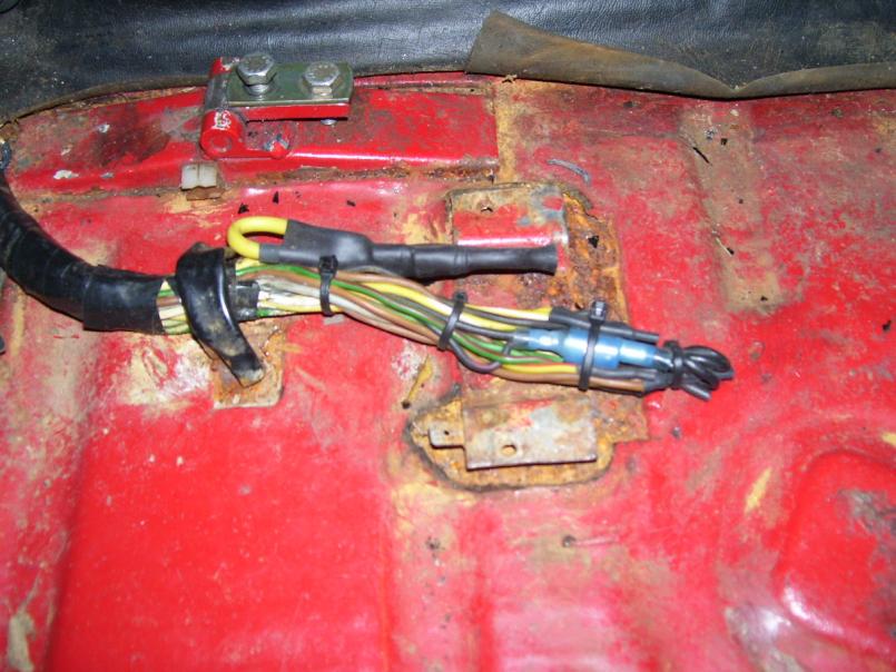

Here's what my '74 looks like where I removed the relay and wrapped all the wires. It all works fine.

QUOTE(zx-niner @ Sep 2 2009, 09:01 PM) *
Great pic Steve. As I said in post #6, tie the yellow wires for the starter together and seal the black/red stripe wires. It is the one that is hot with the key on.
