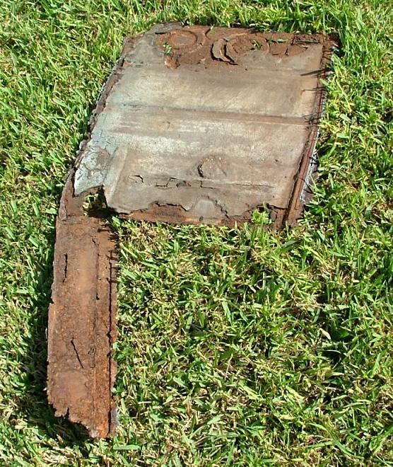

FourBlades
Sep 1 2009, 06:16 AM
Um, my car had a large rusty hole under each of the seats. There was no wiring
left to speak of. I was surprised the seats did not fall through unto the ground.
Click to view attachmentThis was the largest piece of floor pan left in the car... The "good" part is
from the footwell, the "somewhat rusty" part was under the driver's seat.
John

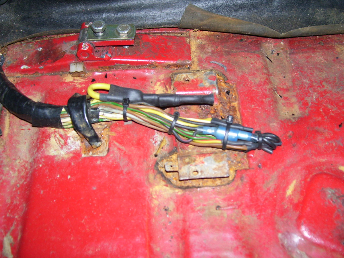

zx-niner
Sep 2 2009, 08:01 PM
Here's what my '74 looks like where I removed the relay and wrapped all the wires. It all works fine.
jt914-6
Sep 2 2009, 08:06 PM
QUOTE(zx-niner @ Sep 2 2009, 09:01 PM)
Click to view attachmentGreat pic Steve. As I said in post #6, tie the yellow wires for the starter together and seal the black/red stripe wires. It is the one that is hot with the key on.
