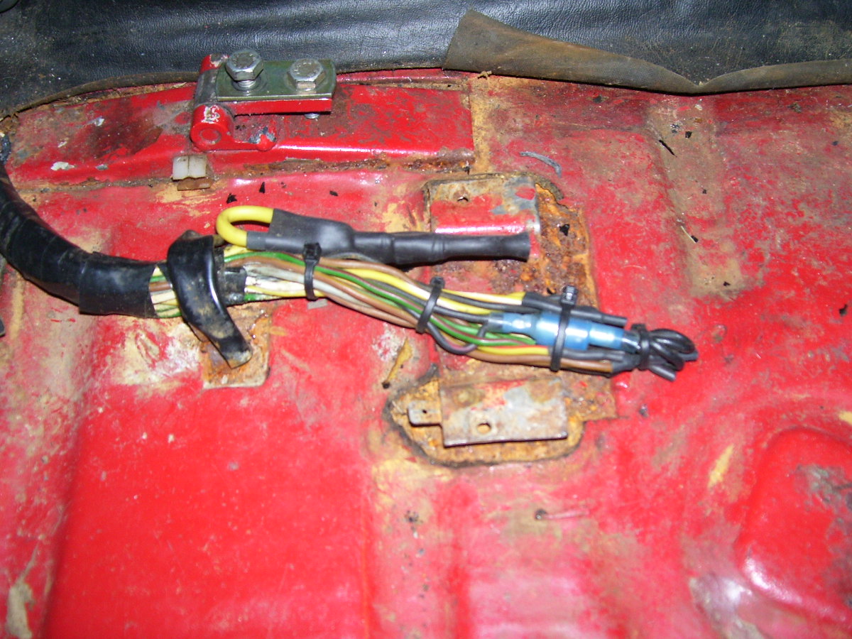

Here's what my '74 looks like where I removed the relay and wrapped all the wires. It all works fine.

QUOTE(zx-niner @ Sep 2 2009, 09:01 PM) *
Great pic Steve. As I said in post #6, tie the yellow wires for the starter together and seal the black/red stripe wires. It is the one that is hot with the key on.
