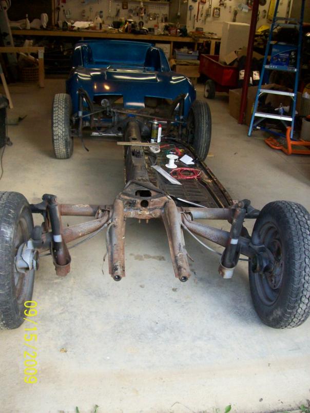

jays914
post Sep 15 2009, 07:46 PM
Posts: 14
Joined: 25-June 09
From: East Liverpool Ohio
Member No.: 10,507
More pictures 9/15/09
jays914
post Sep 15 2009, 07:49 PM
Posts: 14
Joined: 25-June 09
Member No.: 10,507
Yet another picture 9/15/09
jays914
post Sep 15 2009, 07:52 PM
Posts: 14
Joined: 25-June 09
Member No.: 10,507
One last picture for today 9/15/09

Since you already have a 914 engine, why not use a 901 transmission? Out of an early 911. I think that would bolt right up to the engine, and it would give you a 5 speed.
Zach
jays914
post Sep 15 2009, 09:00 PM
Posts: 14
Joined: 25-June 09
Member No.: 10,507
QUOTE(Vacca Rabite @ Sep 15 2009, 10:10 PM) *
Zach
Zach,
More questions.... Will the 901 trans fit into the VW pan? What would be a fair price for the setup? Will the shifter and associated parts need to be purchased and added to the project?
Sorry for all the questions. We would like to do it right at the best price.....
Thanks!
Jay
VaccaRabite
post Sep 15 2009, 09:37 PM
En Garde!
Posts: 13,845
Joined: 15-December 03
From: Dallastown, PA
Member No.: 1,435
Jay,
All I can say is that it has been done. You may have to fabricate some sort of mount. There may even be one on the market.
If you have the skills needed to do this kind of a kit though, you've got the skills needed to weld up a tranny support bar. Looks like you have a fair bit of welding to do anyway.
Zach
Dave_Darling
post Sep 15 2009, 09:38 PM
914 Idiot
Posts: 15,338
Joined: 9-January 03
Member No.: 121
It will fit with some beating, and maybe a little grinding and welding.
You'll need the shifter bits, and you may have to make up a linkage.
--DD
