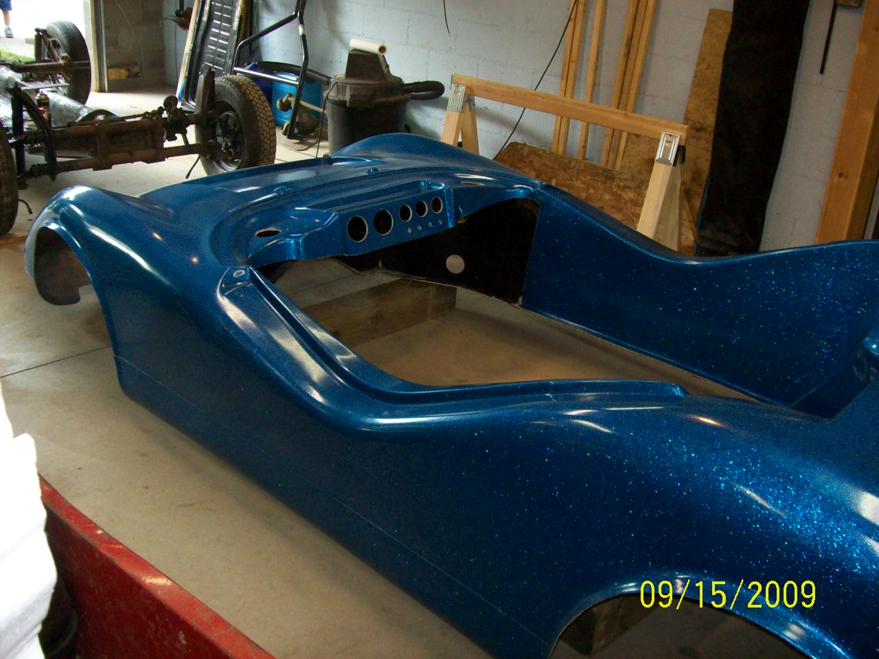

jays914
More pictures 9/15/09

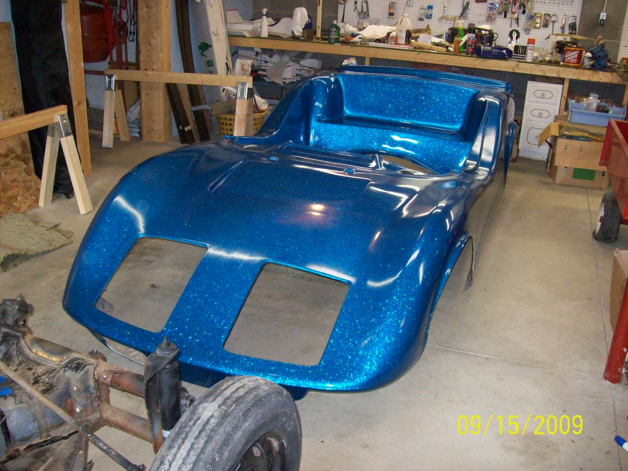

jays914
Yet another picture 9/15/09
