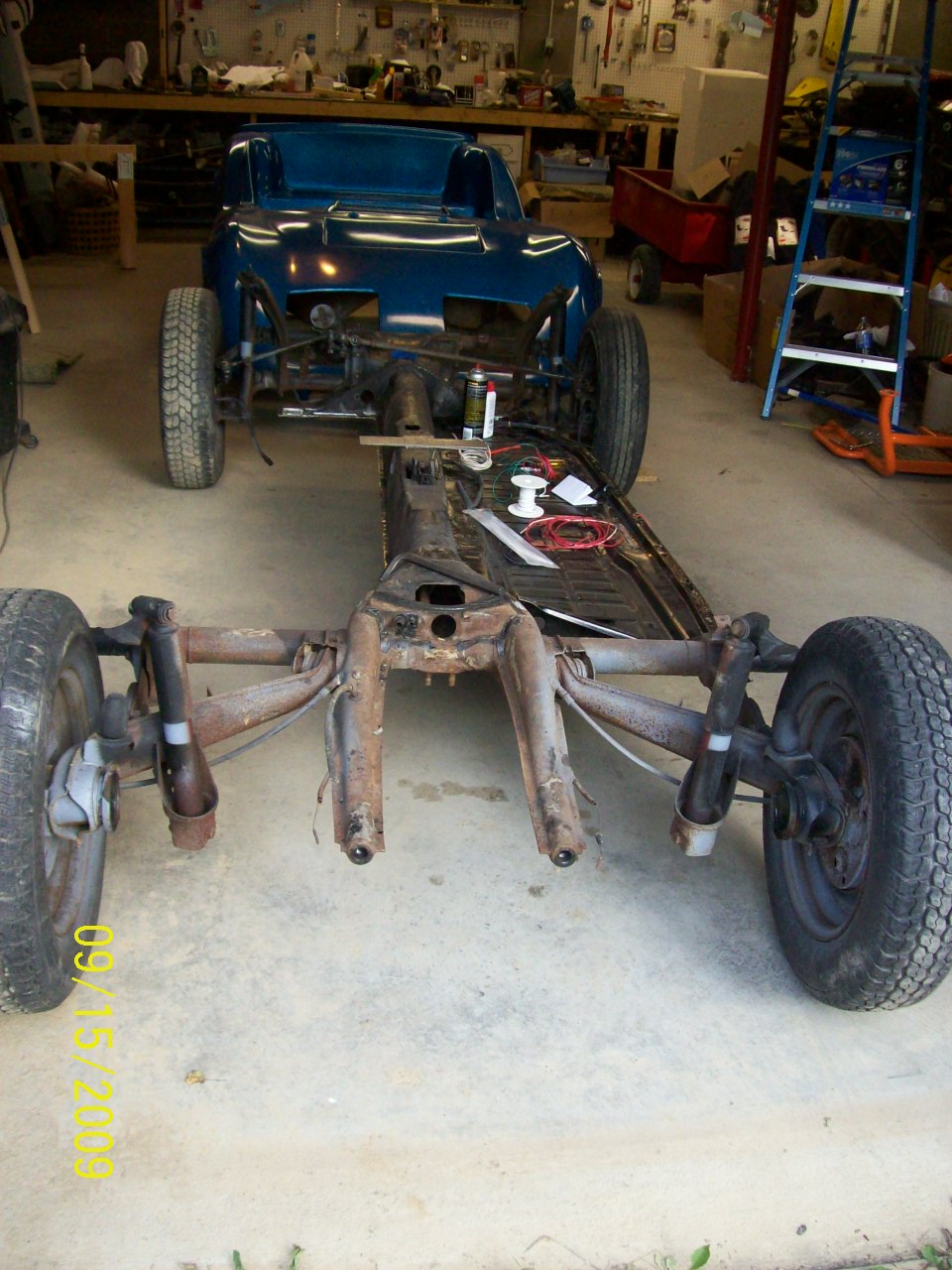

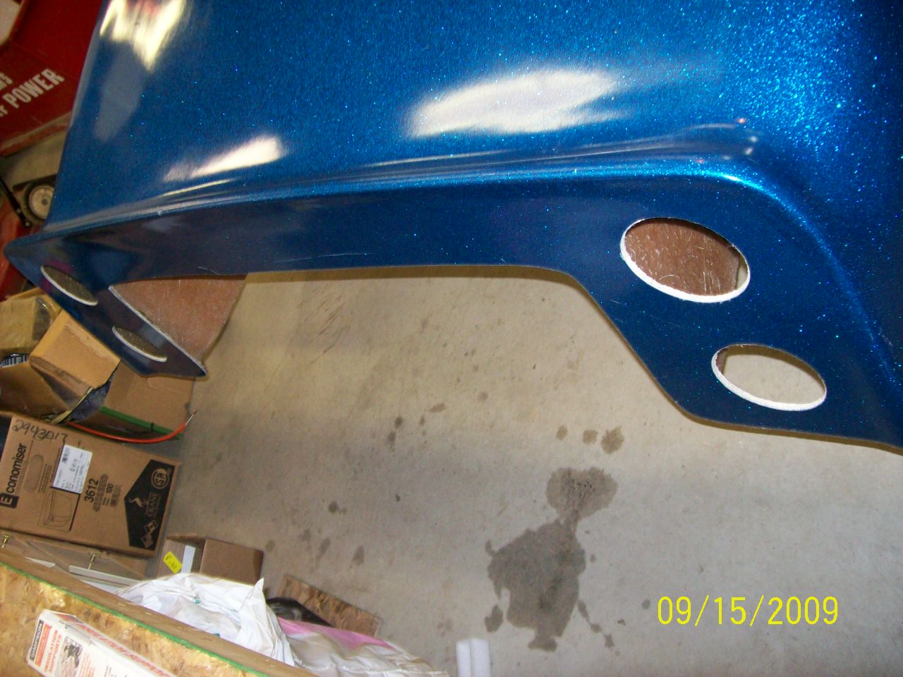

jays914
post Sep 15 2009, 07:46 PM
Posts: 14
Joined: 25-June 09
From: East Liverpool Ohio
Member No.: 10,507

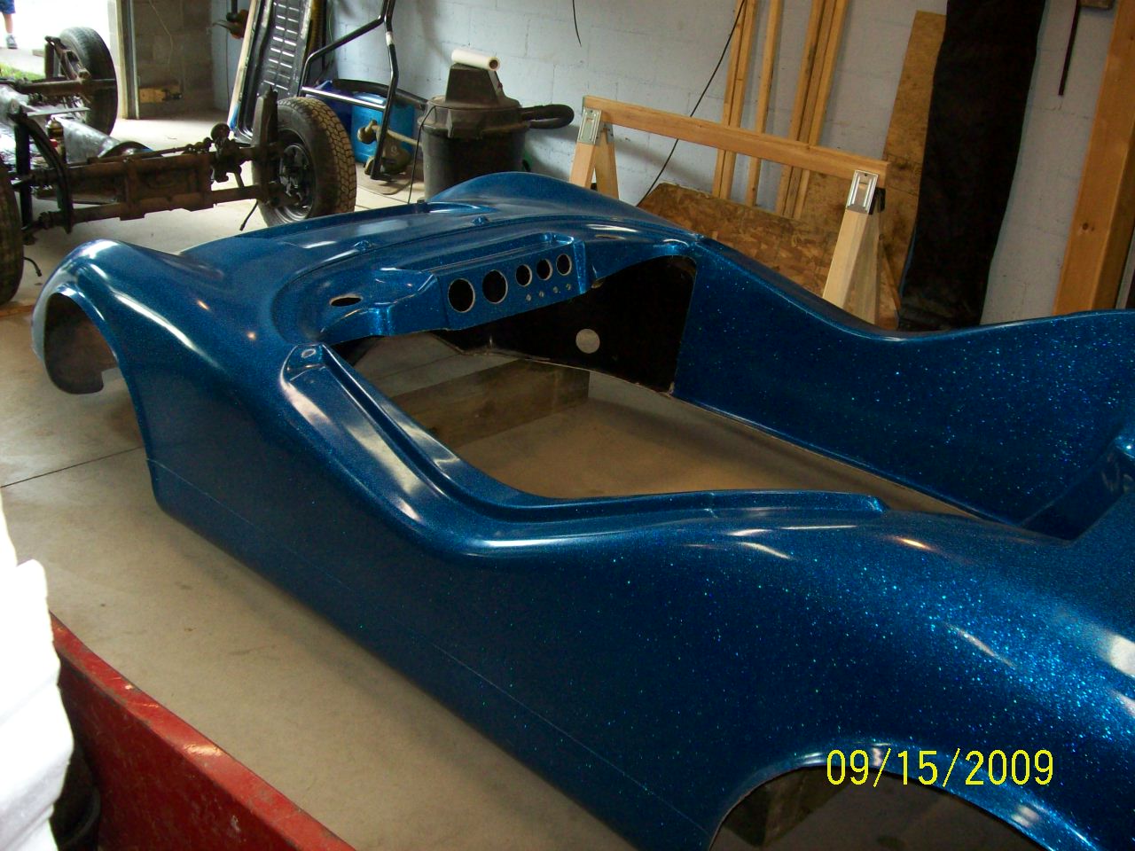

More pictures 9/15/09
jays914

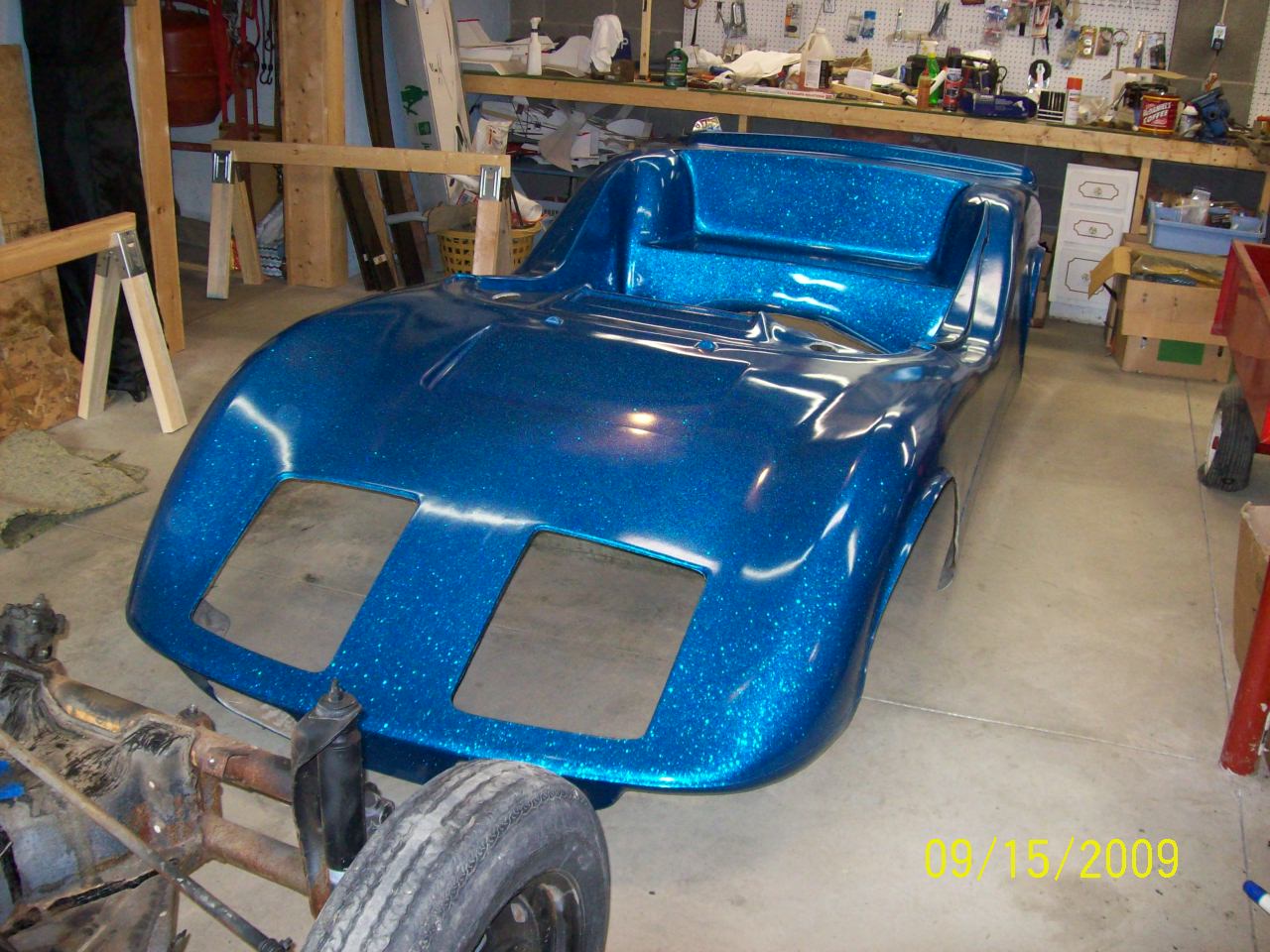

post Sep 15 2009, 07:49 PM
Posts: 14
Joined: 25-June 09
Member No.: 10,507
Yet another picture 9/15/09
jays914
post Sep 15 2009, 07:52 PM
Posts: 14
Joined: 25-June 09
Member No.: 10,507
One last picture for today 9/15/09
VaccaRabite
post Sep 15 2009, 08:10 PM
En Garde!
Posts: 13,845
Joined: 15-December 03
From: Dallastown, PA
Member No.: 1,435
Since you already have a 914 engine, why not use a 901 transmission? Out of an early 911. I think that would bolt right up to the engine, and it would give you a 5 speed.
Zach

Jay,
All I can say is that it has been done. You may have to fabricate some sort of mount. There may even be one on the market.
If you have the skills needed to do this kind of a kit though, you've got the skills needed to weld up a tranny support bar. Looks like you have a fair bit of welding to do anyway.
Zach

jays914
post Sep 17 2009, 01:06 PM
Posts: 14
Joined: 25-June 09
Member No.: 10,507
Zach and Dave,
Thanks for the latest info!
As you guys know that $$$ is always a consideration when doing this kind of project. We are looking for the best compromise. Should we trick it out with a built-up Porsche engine/trans combo or just go with the stock VW parts for now???
My cousin has 2 pipe buggies and another VW pan plus a number of VW engines and transmissions. He also has a very low miles Kia 4 cylinder engine (wrecked car) and complete wiring harness. The main problem with this type of engine is no one makes a conversion kit that we can find. The current flywheel is for an automatiic transmission. The flywheel is close to the Porsche 914 in size and number of bolts to the crankshaft. I think we could have a flywheel machined to match the bolt pattern. We would have to fab an adaptor plate to mount the engine to the transmission. Then mounting a rad/fan and all the other junk...
BTW...VW pans are going to be welded together tonight by a professional welder, then the mounting of the body should come pretty soon, can't wait to see it as a roller.... (IMG:style_emoticons/default/bye1.gif)
Jay
