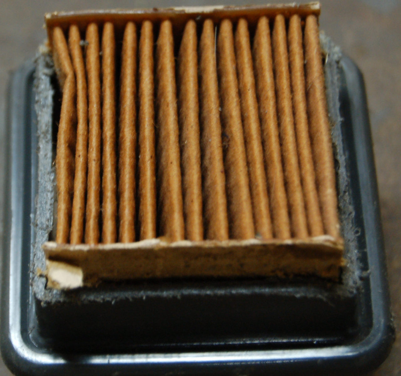

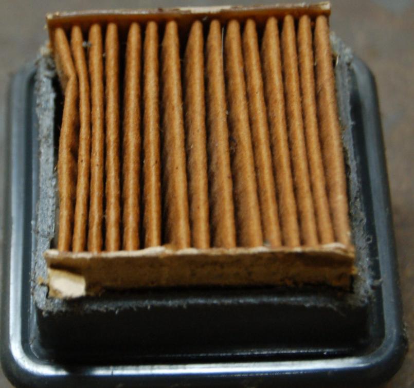

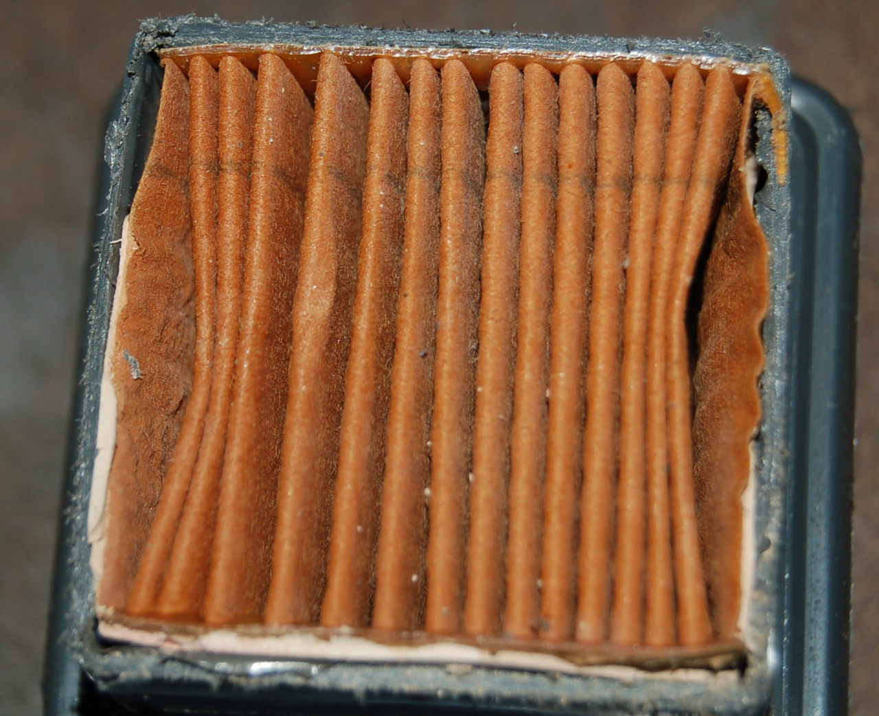

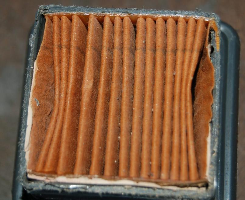

quick update.
Thinking it was the fuel filter I replaced it. I have included some pictures for review, turns out that it was not the filter.
Intermittently the fuel pump was not running when the key was put in the run position. I check the voltage, none at the pump replaced the fuese on the relay board and it looked OK was having some difficulty getting a reading on 86/85 so I cleaned everything with CRC.
Car started no problem. Ran it for a while let it sit and it had a slight problem starting again but this time I think it is the battery even thought it started. The starter was cranking very slowly and would then catch. Reading about 11.84 volts without any load. I will recheck the battery but looks like a new one is in the future.
Heard many positive comments about the optima dry cell 34 R but then read the Captains remarks. What is the consensus?
Regards and thanks everyone for the support.
Dan

The other side of the filter
