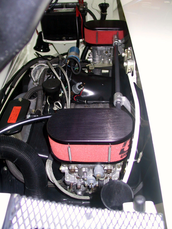

Here's a shot of my bracket...arms pointed to the rear, stock length cable ( terry) and the bracket mounted to the right carb. DH

purple   isnt it ideal to have the cable pull from the cent...   Feb 20 2008, 03:25 PM
maf914   isnt it ideal to have the cable pull from the cen...   Feb 20 2008, 03:52 PM
purple   isnt it ideal to have the cable pull from the ce...   Feb 20 2008, 04:43 PM
KaptKaos   You sure you are getting enough rotation on that l...   Feb 20 2008, 05:47 PM
Kargeek   [/quote]isnt it ideal to have the cable pull from ...   Feb 21 2008, 02:23 AM
purple   Let me just say what everyone is thinking, kargeek...   Feb 21 2008, 11:15 AM
