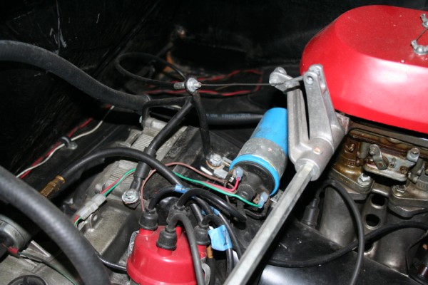

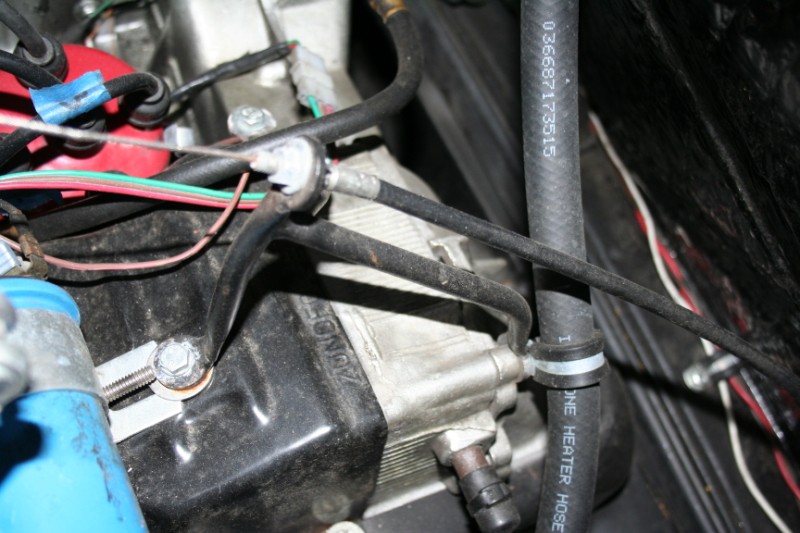

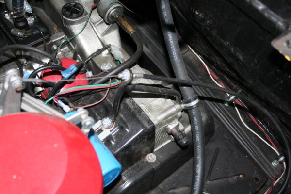

anderssj   OK, a couple more pictures courtesy of CB Performa...   Nov 30 2007, 05:15 PM

anderssj   Bill, REALLY NICE pictures and explanation! ...   Nov 30 2007, 10:17 PM
