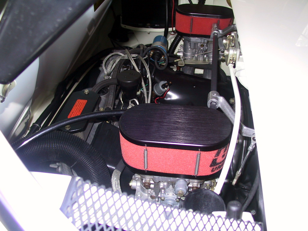

So, I need to order a new throttle cable, which will be run for a carbed motor.
How do I run the cable to the carb link bar? Is there a pulley or channel or something to make the bends easier? What do I need to do to get the leverage to actuate the linkage? Do I need to order a special throttle cable (longer or somehting?)
I'm dumb, pics are helpful. (IMG:style_emoticons/default/huh.gif)
Zach

[/quote]isnt it ideal to have the cable pull from the center of the crossbar, that way if it flexes, it flexes at the same rate for both carbs?
I could put it off to the side easily, but i thought that the crossbar flexing would make syncing hard to do right
Not really, there is no flex with the crossbar. Early 911's have their crossbar bracket for the cable linkage off to one side. I've run mine for over 20 years - no problem.

Kargeek   Here's a shot of my bracket...arms pointed to ...   Feb 20 2008, 02:00 PM

purple   isnt it ideal to have the cable pull from the cent...   Feb 20 2008, 03:25 PM
maf914   isnt it ideal to have the cable pull from the cen...   Feb 20 2008, 03:52 PM
purple   isnt it ideal to have the cable pull from the ce...   Feb 20 2008, 04:43 PM
KaptKaos   You sure you are getting enough rotation on that l...   Feb 20 2008, 05:47 PM
Kargeek   [/quote]isnt it ideal to have the cable pull from ...   Feb 21 2008, 02:23 AM
purple   Let me just say what everyone is thinking, kargeek...   Feb 21 2008, 11:15 AM
