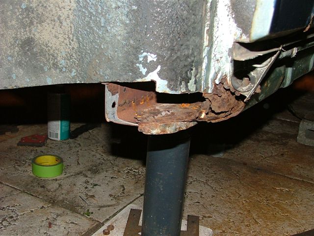

Fixing the driver side footwell and long. It is missing the front of the inner fender
and most of the end of the long.

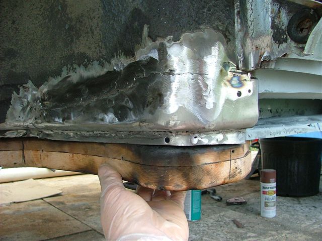

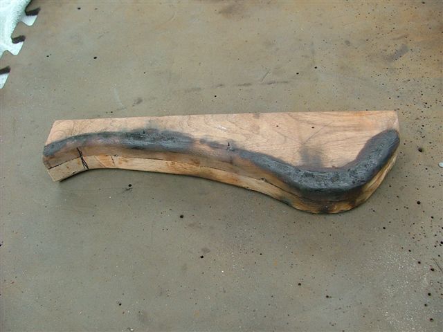

Made a hammer form to make a replacement for the curved part at the bottom
of the inner fender. I used the same form on the passenger side by routing a
curve into both sides of the form. The form is made from scrap hardwood that
was cut to match the shape of the curve of the fender. I screwed the metal piece

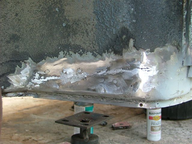

to the form in three places to hold it while hammering it into shape. I welded a
strip to the bottom to form the pinch weld with the bottom of the floor and with the
end of the long. It got a little toasted during the welding, but it kept the new
piece in the right shape until the welding cooled.
Hammer formed part welded to the inner fender.
Hammer form held up to the part it was used to make. The new metal piece
was hammered around the bottom lip of the form. The passenger side was
fixed using a piece hammered around the top of the form.
