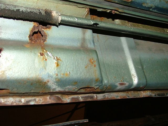

The end of the driver long does not look too bad on the outside. Just some rust holes and surface rust???

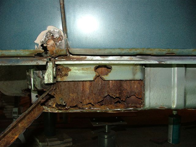

Cutting off the outer most layer reveals load of rust.

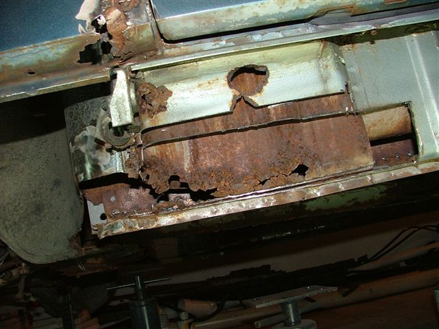

Cutting off the next layer reveals yet more rust, mostly at the bottom of the long.

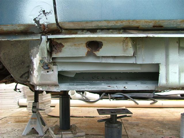

Clean all the rust, use metal prep and prime all the layers and innards. Also welded on the hammer formed fender patch.
