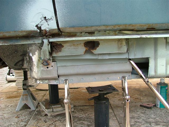

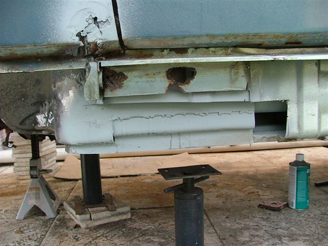

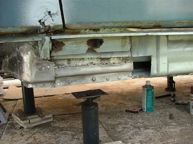

Rebuilding the first layer of the onion.
Made a patch for the innermost layer.
Welded the patch.
Grind down and prime the innermost layer.
