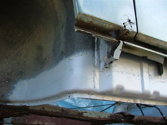

Rebuilding the second layer of the onion.
Made a patch using the end of a restoration design inner long. I used the top
of the end to make a sleeve to make welding the patch on easier. Here you
can see the sleeve which has been rosette welded in place in the top of the hole.
Because the sleeve was made from the top of the patch, it fits perfectly and
takes little time to make.

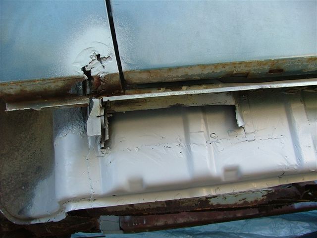

Here is the patch itself. I punched holes for rosette welding, which is way
faster and neater than drilling. A $20 hand operated metal hole puncher
is a cheap way to save some time.

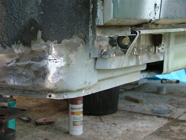

Welded, ground, and primed. I hate to grind too much and weaken the whole
repair just to get a perfectly flat surface. Maybe some all-metal filler to smooth
it out???-
Not perfect, but better than the rusty, gaping hole.

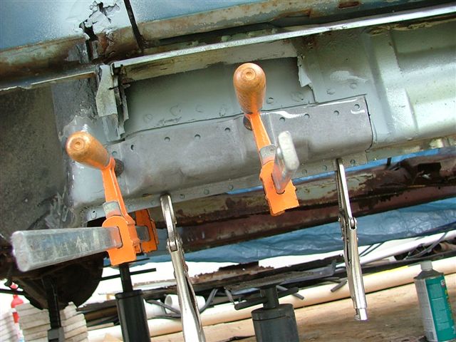

FourBlades   Fixing the driver's side jacking point. I cut...   Mar 31 2008, 08:31 PM
