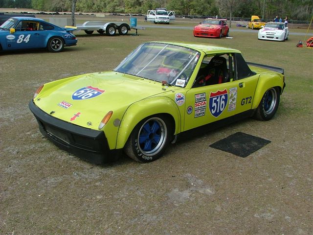

But first, some pictures from Roebling Road driver's education last weekend.
There were several very fast race prepped 914s howling around the track.
The yellow car was fastest everywhere except the main straight, and appeared
to me to be pulling away from the two Carrera GTs that were out. I never saw
any car pass this car all weekend including the 997 turbos, 997 GT3s, 997 RSs.
This 914 was definitely the loudest car there. The owners told me they had
$100,000 into it and were selling it for somewhere around $40,000 after winning
two SARRC championships with it. Too bad I blew all my funds on pork rinds,
beer and 914 parts already... (IMG:style_emoticons/default/biggrin.gif) (IMG:style_emoticons/default/biggrin.gif) (IMG:style_emoticons/default/biggrin.gif)

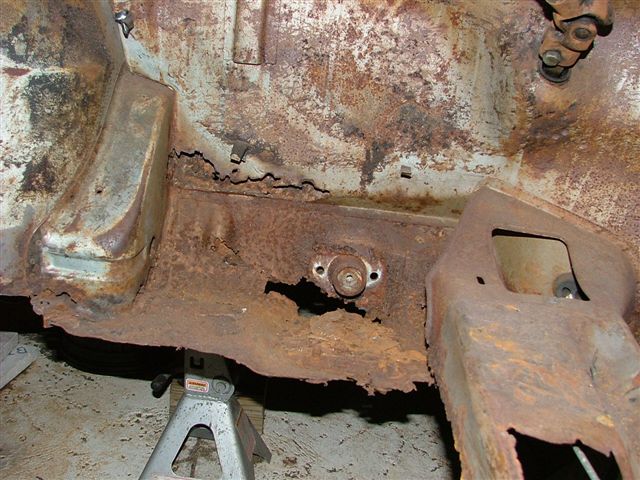

FourBlades   Fixing the driver side footwell and long. It is m...   Feb 22 2008, 06:44 PM
FourBlades   :blink: :blink: Peeling the rust bucket onion :...   Feb 22 2008, 06:53 PM
