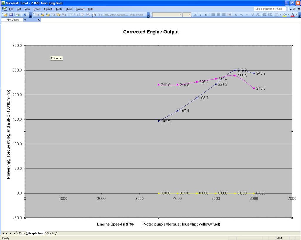

I did this on Thursday.
Pump gas, TIV non aftermarket head castings twin plugged with LE 225 treatment. The intake ports are NOT WELDED!!
The engine ran for 3 days on 4 gallons of fuel in the dyno cell while I searched for the proper tune.. It had BSFC numbers as low as a 2270 engine and wouldn't get to 350F head temp no matter how hard I tried.
It idles at 700 RPM smoother than stock and doesn't need more than 5,500 RPM to make it's power.
Yeah, we have advanced to the next level.... Again.
The same base engine made only 235 HP with big aftermarket single plug heads in 2005 with 2.5mm MORE bore and 80 CFM more port flow and the SAME cam..
Bigger is not better-
