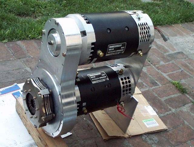

6v X 20 (batteries) and a Zilla controller. The 6v batteries pack a HUGE punch......double DC motor.....

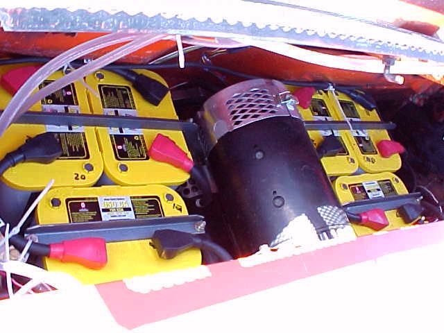

Check out Otmar's ride....arrrararrararraaarrrr, power.....he's running 240v with 20 Exide Orbital, 12.00 Volt, Lead-Acid, AGM....he must have a deal with a battery company cause that big $$ in batteries.....
http://www.evalbum.com/293
(IMG:http://www.evalbum.com/img/293/293c.jpg)
(IMG:http://www.evalbum.com/img/293/293e.jpg)
