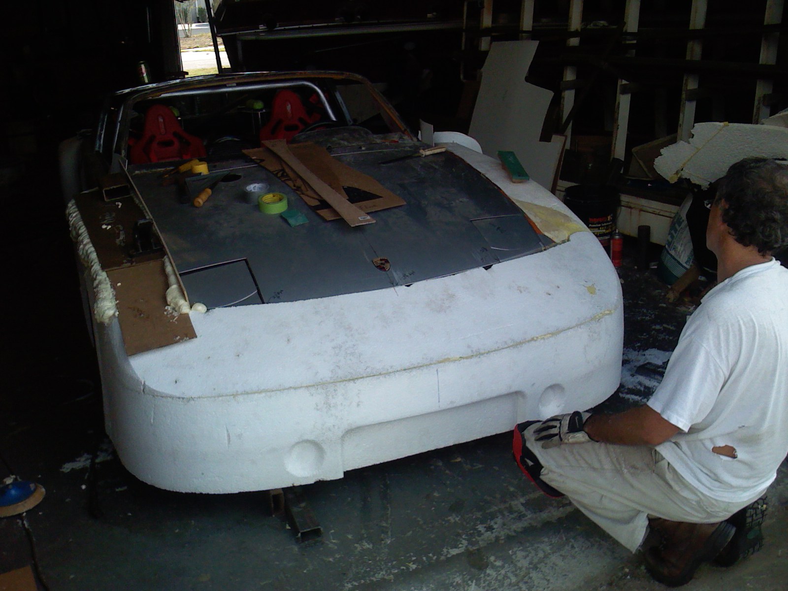

Hey guys, am pretty new here, mostly a pelicanite. Just like to share some photos of my 'projekt 908' which i have been working on for a year or so. I started with a basket case 914 with a standard 2.7 conversion, that had been languishing under it's PO. I had the desire to create something unique and personal, and learn how to be a better welder and fiberglass worker in the meantime. I have always thought the 914 could look must better with a little tweaking... namely a lower roofline and better front end. The 908's front end was always so simple and classic, that it seemed a natural. Started with
Then added some flares and centerlock wheels
Then built a front end out of foam and plater based on photos of the 908/3

turbo914v8   Hey, great work with that kit and let me be the fi...   Mar 1 2008, 03:11 PM
jim_hoyland   Reduce the pic size to small befor uploading. Nice...   Mar 1 2008, 03:17 PM
swl   pretty impressive sculpting! Pic problem is p...   Mar 1 2008, 03:19 PM
quadracerx   WOW....that is cool..... :trophy: Did you or do ...   Mar 1 2008, 03:22 PM
juicersr   Thanks guys, here is a link to the pelican board w...   Mar 1 2008, 03:37 PM
SirAndy   Thanks guys, here is a link to the pelican board ...   Mar 1 2008, 03:44 PM
juicersr   Thanks andy. My schedule is crazy and dont have a...   Mar 1 2008, 04:02 PM
Zimms   Looks good. Do you know if the new front end is mo...   Mar 1 2008, 04:03 PM
juicersr   The front weigh about 40 lbs or so (havent weighed...   Mar 1 2008, 04:15 PM
juicersr   Oh, and my buddy and i are learning to work with C...   Mar 1 2008, 04:43 PM
michaelt55   great job...looks impresive..now if its made out o...   Mar 1 2008, 04:51 PM

sww914   Cool car! I think that the fiero comment was u...   Mar 2 2008, 12:36 AM
JPB   Nice work and crazy straight! :beer1:   Mar 2 2008, 07:23 AM
juicersr   Thanks fellas, doing this stuff makes you even mor...   Mar 2 2008, 03:19 PM
