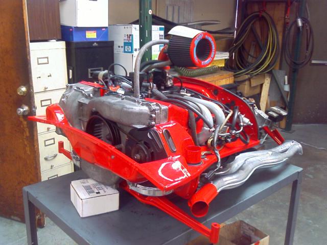

The header system works well up thru 2.2 Ltr. T-4s, no problem on your 2056 !
We highly suggest NO wraps of any kind on our (any mfgs) exhaust systems. It basically accelerates the corrosive process by trapping moisture and rusting thru the tubing of the header/ exhaust/muffler. We deny any warranty claims on MSDS items that have been wrapped, and most other mfgs do likewise.
If your looking to keep heat away from engine components, thermal sleeve the cables, or spend a little more $$ and send your exhaust out for ceramic coating.
The HBs in the pic of our 2.0 CI class engine (shown here) are coated in Xtreme(brand) metallic ceramic coating (Oxnard CA). After 20 minutes engine shutdown you can touch the exhaust system.
Marty
