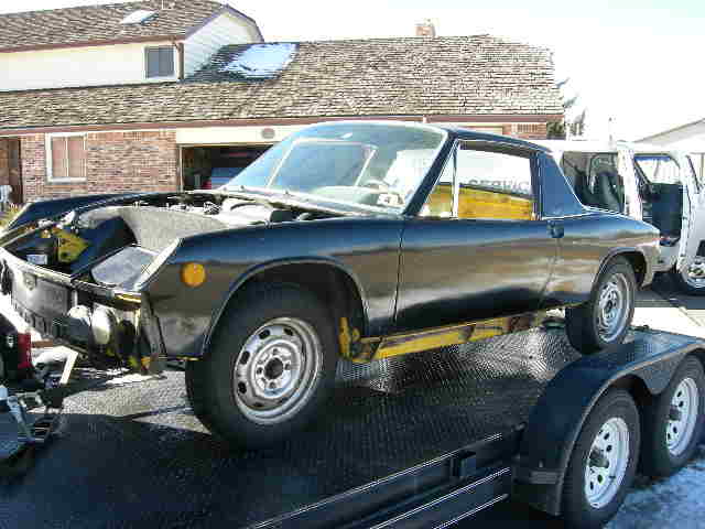

Just sold a tub to a guy in Aurora for an electric conversion. It will be his second. Gave him info about this site but have not heard from him since. He is suppose to contact us about an interior and some other parts. Will tell him about this thread if he ever calls back.
