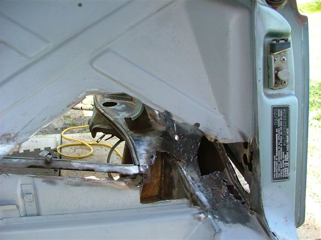

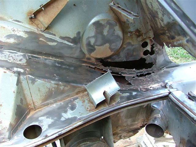

Now it is time to fix the "Heck Hole" which is like the Hell Hole only on
the driver's side. It is not as bad as the Hell Hole, thus the name.
Today I have a work crew to help me out:
Heck Hole after lots of grinding, cleaning and some metal ready.

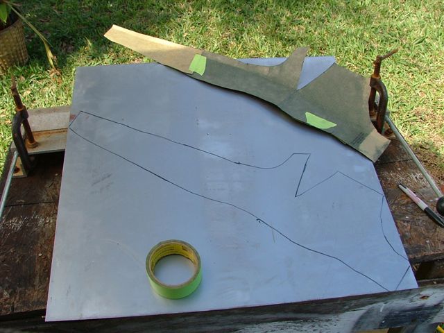

Made a template for a large 16 gauge patch.
Next I will weld the patch on and fix the firewall.
