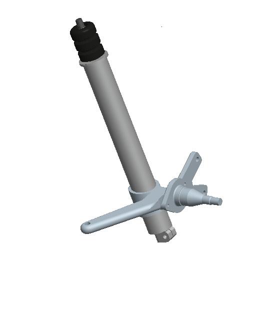

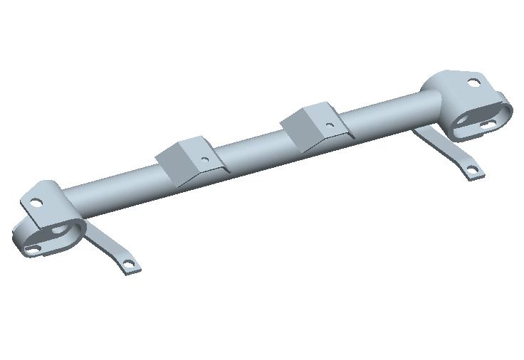

a little update for you all
thanks to ray, i was able to get measurements of the 914 suspension points for the kinematic model, and thanks to bob at stable energies, i have the components to model. Our professor really likes this project so he chose us to compete in an ASME oral presentation contest in april...so i have ALOT of work to do.
I am currently finishing the solid model of the stock control arm, which i will do a structural analysis of, using track data generously provided by the members here.
so things should be picking up soon
here are a few pics of the solid models i have
