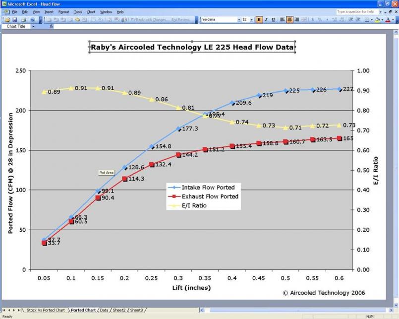

This engine has intake ports that flow 225 CFM, these are the only port that has outflowed the capability of a Weber IDF to date, hence the use of an IDA.These ports have the volume to overcome the characteristics that make an IDA equipped TIV hard to tune.
This car was built (including the engine) in 3 weeks time by Blake and myself for a single day of competition at the SE Dyno Day. Due to that we did not have time to install and tune the EFI system that would generally be used with this arrangement.
IDAs in 95% of instances do not work well with the characteristics of the TIV heads, this is the odd 5% situation where they do work very effectively.
That said IDAs were my last and only resort to beat the Cali guys given the time I had to get the job done.

Jake Raby   This engine has intake ports that flow 225 CFM, th...   Mar 19 2008, 02:48 PM
