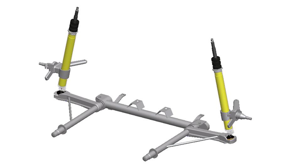

hey everyone, i figured id post this here to see what you all thought
I am a ME student at NJIT and for a senior design project, Myself and 2 other students will be redesigning the front suspension of the 914. the goal of the project will be to optimize the structural rigidity of the control arm while decreasing weight, also to try and optimize the camber curves and adjustability for racing use.
prettymuch we would be designing a racing control arm. depending on the results, this may be something that could go into a production run..who knows
what im asking is for donations of stock parts. A arms, shocks, tie rods...
i want to try and recreate a front corner of the car that will be easy to modulate and work on for demonstration and testing purposes.
so let me know your thoughts/ideas
thanks
Aaron

a little update here, ive been working all week like crazy creating a presentation for the ASME oral presentation competition tomorrow in CT. im still trying to finish it now. Ive got the new control arm prettymuch designed and have done some FEA on it, but i wont post pictures until i know its good....for now though, heres my assembly of the front end, enjoy
