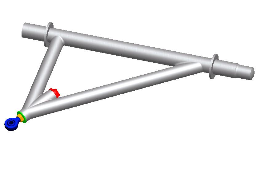

hey everyone, i figured id post this here to see what you all thought
I am a ME student at NJIT and for a senior design project, Myself and 2 other students will be redesigning the front suspension of the 914. the goal of the project will be to optimize the structural rigidity of the control arm while decreasing weight, also to try and optimize the camber curves and adjustability for racing use.
prettymuch we would be designing a racing control arm. depending on the results, this may be something that could go into a production run..who knows
what im asking is for donations of stock parts. A arms, shocks, tie rods...
i want to try and recreate a front corner of the car that will be easy to modulate and work on for demonstration and testing purposes.
so let me know your thoughts/ideas
thanks

post Apr 7 2008, 10:52 PM
Posts: 1,547
Joined: 6-May 04
From: Nutley, NJ
Member No.: 2,030
the presentation went well i think, i didnt win anything, but ALOT of students and people were coming up to me after, complimenting me and wanting to talk about it....i guess that porsches are more interesting than carbon nanotubes or 6 DOF Matlab M files (those guys won)
anyways, its looking good, and im hoping to build some prototypes soon
heres a pic of the basic design

jd74914   Very cool Aaron! Are you trying to optimize ...   Nov 12 2007, 04:17 PM
Brando   Design an affordable front-coil-over system :)   Nov 12 2007, 05:42 PM
d914   if the jersey boys don't cough one up, Ive got...   Nov 12 2007, 06:46 PM
Borderline   Great Project! Are you going to do any testin...   Nov 12 2007, 06:56 PM
i love porsche   its going to keep the stock chassis mounting point...   Nov 12 2007, 06:59 PM
rmital   what im asking is for donations of stock parts. ...   Nov 13 2007, 12:21 PM
neilca   Let me give you a hint. Extend the lower control a...   Nov 13 2007, 12:33 PM
neo914-6   Sounds good but why not the take a bigger challeng...   Nov 13 2007, 03:01 PM
i love porsche   felix...good question...i thought about it and thi...   Nov 13 2007, 11:41 PM
LarryR   How about a double A arm coil over set up on all f...   Nov 14 2007, 12:06 AM
i love porsche   How about a double A arm coil over set up on all ...   Nov 14 2007, 06:39 AM

i love porsche   a little update here, ive been working all week li...   Apr 4 2008, 10:44 AM
jd74914   That looks good Aaron. It'll be interesting to...   Apr 4 2008, 11:09 AM
jd74914   Edit: Deleted duplicate resulting from trigger hap...   Apr 4 2008, 11:10 AM
i love porsche   the competition is at central connnecticut state u...   Apr 4 2008, 11:47 AM

i love porsche   so i have a little request, i would like to get do...   Apr 9 2008, 02:04 PM
Brando   Control arms? You mean fron A-Arms? The rear are ...   Apr 9 2008, 02:16 PM
i love porsche   yes, front A arms   Apr 9 2008, 02:41 PM
i love porsche   ok well here are some pictures of the finished pro...   May 20 2008, 12:09 PM
i love porsche   this was probably the best weld of the bunch al...   May 20 2008, 12:11 PM
rick 918-S   Welding is only learned by practicing...alot! ...   May 21 2008, 07:24 AM
type11969   Did the torsion tubes warp at all when welding the...   May 21 2008, 08:22 AM
Spoke   Nice work. I agree with you about the ball joints....   May 21 2008, 12:02 PM
i love porsche   thanks for that link chris, ill have to give him a...   May 21 2008, 01:27 PM
jd74914   Looks good Aaron. Worst case with the warpage yo...   May 21 2008, 07:19 PM
