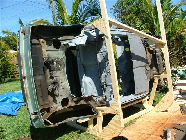

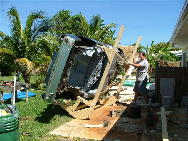

Flip Your 914 Part Deux
When the car was tipped about 40 degrees it started to get very light.
At this point I figured I would see what happened if I pushed it the rest
of the way by hand.
Tipping it the rest of the way was much like using a large dolly to move
a filing cabinet. It is easy to get it back to the balancing point but going
back to flat from there it gets really heavy.
Thanks to careful calculations and planning it all worked out. (IMG:style_emoticons/default/rolleyes.gif)
Looking forward to finishing the floor in a more vertical position.
John

QUOTE(FourBlades @ Apr 13 2008, 05:21 PM) *
It's like a 914 Rocking Chair.............Cool (IMG:style_emoticons/default/aktion035.gif)
