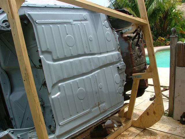

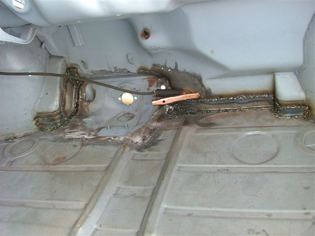

Finished welding on the floor pans and primed them. Cleaned up a lot of little
holes and imperfections that were noticeable with the car on its side.

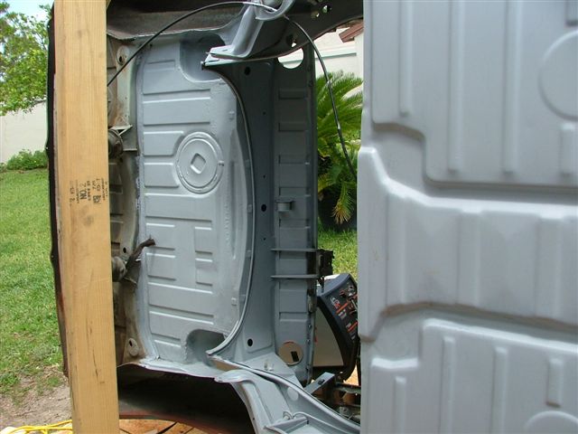

Spent some time cleaning the back of the engine bay and underside of the
rear trunk while I have the car this way.
