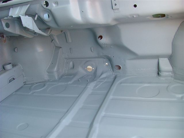

FourBlades   Finished welding on the floor pans and primed them...   Apr 25 2008, 12:03 PM
FourBlades   Primed front of passenger compartment and floor pa...   Apr 26 2008, 05:44 PM
