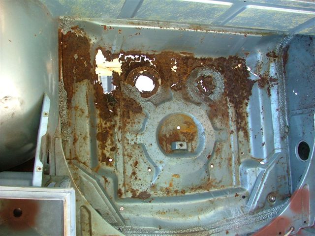

I am starting on restoring a $500 914 that was left in a field for several years with no windshield. The car belonged to the POs older brother and thus has sentimental value. The sold it to me on the condition that I not part it out. I was looking for a project so this was fine with me. This is my first restoration project so I figured I would learn a lot (IMG:style_emoticons/default/biggrin.gif) (IMG:style_emoticons/default/biggrin.gif) (IMG:style_emoticons/default/biggrin.gif)
The car is a mixture of really good sections, appears to have suffered no major accidents, is straight, never been repainted--but it has totally rusted out floors and hell hole. All the suspension mounting points are not rusted. The door gaps are all even and good. If I can replace the floors, I think it will be a good straight car. Many small parts were stolen while it was "stored" and the wiring loom is a complete loss.
Thanks for any comments...John

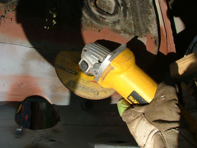

Time to fix the front trunk. I would not trust this thing the way it is with a
case of beer, even light beer.

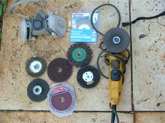

The battle lines are drawn. Nothing can withstand the knotted wire wheel
(with the green center). <Imagine grinder smilie here>
Grind the questionable areas until good metal is found. This helps determine
how much needs to be cut out.
Draw lines around what needs to go and cut it out.
