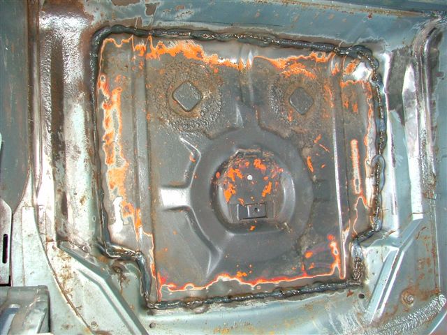

Seam welded in between the tacks on the new front trunk. Jumped around from
one edge to the other frequently and took a few breaks to let it cool off.
It actually looks pretty good. Total time about 4 hours. Next session a little
grinding and priming should do it. The rear trunk is much more complicated
and will be much harder.
John
