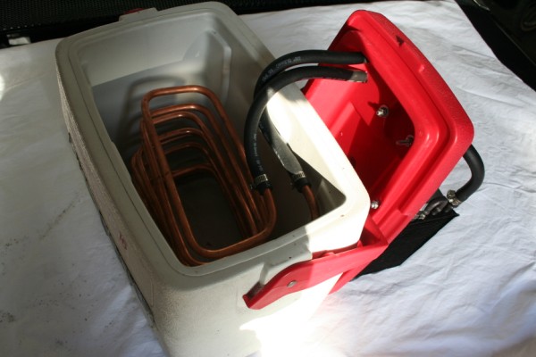

I researched these air conditioners on the internet and found they cost about $700 to buy. I thought I might try to make one myself. How hard could it be rite? I started with a closed loop water circulation system. It is powered by a 12 volt 2 amp pump with a gallon per minute output. I got it at the local RV parts store. Bent some 3/8 inch copper tubing to fit into an old cooler we have in the garage. Connected some 3/8 rubber hose and used a heat exchanger I bought at a flea market for $5. Filled it with water and tried to bleed out as much air as possible.

It fits into the cooler and the cooler is filled with water and ice.

Elliot Cannon   I know the concept works. You can google them and...   Apr 30 2008, 12:36 AM

blitZ   Pretty slick and should work well. I have seen a ...   Apr 30 2008, 06:22 AM

marks914   I am going to try this with my heat exchanger inst...   Apr 30 2008, 09:39 AM
Elliot Cannon   I am going to try this with my heat exchanger ins...   Apr 30 2008, 11:13 AM
marks914   You could probably run a bilge pump in the bottom ...   Apr 30 2008, 09:54 AM

jasons   My guess is, there is some thermal dynamic formula...   Apr 30 2008, 11:09 AM

ClayPerrine   Nice idea.. but it seems like a lot of work for so...   Apr 30 2008, 11:56 AM
