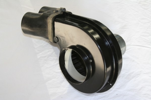

I researched these air conditioners on the internet and found they cost about $700 to buy. I thought I might try to make one myself. How hard could it be rite? I started with a closed loop water circulation system. It is powered by a 12 volt 2 amp pump with a gallon per minute output. I got it at the local RV parts store. Bent some 3/8 inch copper tubing to fit into an old cooler we have in the garage. Connected some 3/8 rubber hose and used a heat exchanger I bought at a flea market for $5. Filled it with water and tried to bleed out as much air as possible.

I built a plenum and will use this blower to force fresh air into it to be cooled by the heat exchanger. (Not sure if should be called a heat exchanger but you know what I mean right?) Cold exchanger? Anyway.

Elliot Cannon   I used a Shop Vac hose for ducting and I had a dou...   Apr 30 2008, 12:12 AM

drive-ability   thats nice, I wonder how well it will work? I woul...   Apr 30 2008, 12:25 AM
Elliot Cannon   I know the concept works. You can google them and...   Apr 30 2008, 12:36 AM
