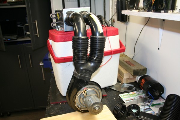

I researched these air conditioners on the internet and found they cost about $700 to buy. I thought I might try to make one myself. How hard could it be rite? I started with a closed loop water circulation system. It is powered by a 12 volt 2 amp pump with a gallon per minute output. I got it at the local RV parts store. Bent some 3/8 inch copper tubing to fit into an old cooler we have in the garage. Connected some 3/8 rubber hose and used a heat exchanger I bought at a flea market for $5. Filled it with water and tried to bleed out as much air as possible.

Here's the other side. I will also make a longer handle so it clears the plenum and pump. I hope to have one working for the ride up to the WRC. The blower and the pump will run on the 914 electrical system OK and I tested it and it seems to blow a good amount of volume. I need to test how cold the air is when it exits the plenum. I might try that tomorrow if there isn't too much to do around the house.

sww914   Cool :D Idea!   Apr 30 2008, 12:17 AM
Sleepin   Pretty neat idea for alot of applications! I c...   Apr 30 2008, 12:23 AM
drive-ability   thats nice, I wonder how well it will work? I woul...   Apr 30 2008, 12:25 AM
Elliot Cannon   I know the concept works. You can google them and...   Apr 30 2008, 12:36 AM
So.Cal.914   "Go Gadgit Teener"! Can ya see Elli...   Apr 30 2008, 01:04 AM
GWN7   compact swamp cooler.... nice......add salt to the...   Apr 30 2008, 01:28 AM
Sleepin   Adding salt would do that. I remember making ice c...   Apr 30 2008, 02:54 AM
blitZ   Pretty slick and should work well. I have seen a ...   Apr 30 2008, 06:22 AM
johannes   fill it with liquid azote ;)   Apr 30 2008, 07:05 AM
SLITS   You should have bought Mike Zs' Cool Suit that...   Apr 30 2008, 07:33 AM
Cap'n Krusty   Is it just me, or is it really scary that "My...   Apr 30 2008, 09:27 AM
marks914   I am going to try this with my heat exchanger inst...   Apr 30 2008, 09:39 AM
Elliot Cannon   I am going to try this with my heat exchanger ins...   Apr 30 2008, 11:13 AM
marks914   You could probably run a bilge pump in the bottom ...   Apr 30 2008, 09:54 AM
MoveQik   Elliot has been flipping through the Sporty's ...   Apr 30 2008, 10:10 AM
So.Cal.914   Any air volume is good when over a hundred degrees...   Apr 30 2008, 10:18 AM
angerosa   That is way cool! I actually had I colleague a...   Apr 30 2008, 10:53 AM
Elliot Cannon   That is way cool! I actually had I colleague ...   Apr 30 2008, 11:20 AM
jasons   My guess is, there is some thermal dynamic formula...   Apr 30 2008, 11:09 AM
Aaron Cox   so thats what retired people do.... Spend money to...   Apr 30 2008, 11:47 AM
ClayPerrine   Nice idea.. but it seems like a lot of work for so...   Apr 30 2008, 11:56 AM
MoveQik   Did you ever consider putting an AC unit on the c...   Apr 30 2008, 12:40 PM
ClayPerrine   Did you ever consider putting an AC unit on the ...   Apr 30 2008, 03:03 PM
