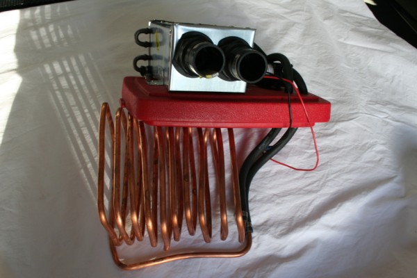

I researched these air conditioners on the internet and found they cost about $700 to buy. I thought I might try to make one myself. How hard could it be rite? I started with a closed loop water circulation system. It is powered by a 12 volt 2 amp pump with a gallon per minute output. I got it at the local RV parts store. Bent some 3/8 inch copper tubing to fit into an old cooler we have in the garage. Connected some 3/8 rubber hose and used a heat exchanger I bought at a flea market for $5. Filled it with water and tried to bleed out as much air as possible.

My guess is, there is some thermal dynamic formula to optimize the exchange, using the surface area and number of loops of the copper, relative to the surface area and loops of the exchanger you are missing. But what do I know? My engineering degree is in computers, and they don't have engines.
I've wondered if you could use a Peltier device to make an air conditioner.

Elliot Cannon   It fits into the cooler and the cooler is filled w...   Apr 30 2008, 12:09 AM
Elliot Cannon   I built a plenum and will use this blower to force...   Apr 30 2008, 12:10 AM
Elliot Cannon   I used a Shop Vac hose for ducting and I had a dou...   Apr 30 2008, 12:12 AM
Elliot Cannon   Here's the other side. I will also make a lon...   Apr 30 2008, 12:17 AM

Elliot Cannon   I know the concept works. You can google them and...   Apr 30 2008, 12:36 AM

blitZ   Pretty slick and should work well. I have seen a ...   Apr 30 2008, 06:22 AM

marks914   I am going to try this with my heat exchanger inst...   Apr 30 2008, 09:39 AM
Elliot Cannon   I am going to try this with my heat exchanger ins...   Apr 30 2008, 11:13 AM
marks914   You could probably run a bilge pump in the bottom ...   Apr 30 2008, 09:54 AM

angerosa   That is way cool! I actually had I colleague a...   Apr 30 2008, 10:53 AM
Elliot Cannon   That is way cool! I actually had I colleague ...   Apr 30 2008, 11:20 AM
jasons   My guess is, there is some thermal dynamic formula...   Apr 30 2008, 11:09 AM
