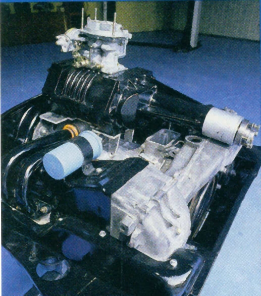

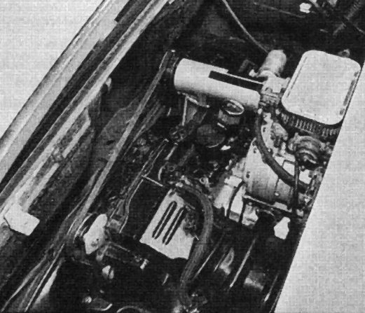

Has anyone ever built or know someone who has built a intake manafold
to install a (Ford,GM, or import) supercharger on a 914-4 or 6? (IMG:style_emoticons/default/welder.gif)

Here are 3 S/C photos I have, I have no further details:

Jake Raby   I have a half dozen TIV S/C builds under my belt.....   May 16 2008, 01:16 PM
Porschedub   Hi Jake! Do you have any photos of that 914 S/...   May 16 2008, 01:23 PM
Jake Raby   That sounds like my kind of build.. BUT I don...   May 16 2008, 02:05 PM
Porschedub   Hi Jake! What i'm looking for is an SC int...   May 16 2008, 04:01 PM
Jeff Bowlsby   Here are 3 S/C photos I have, I have no further de...   May 16 2008, 02:22 PM
Jeff Bowlsby   tres...   May 16 2008, 02:22 PM
