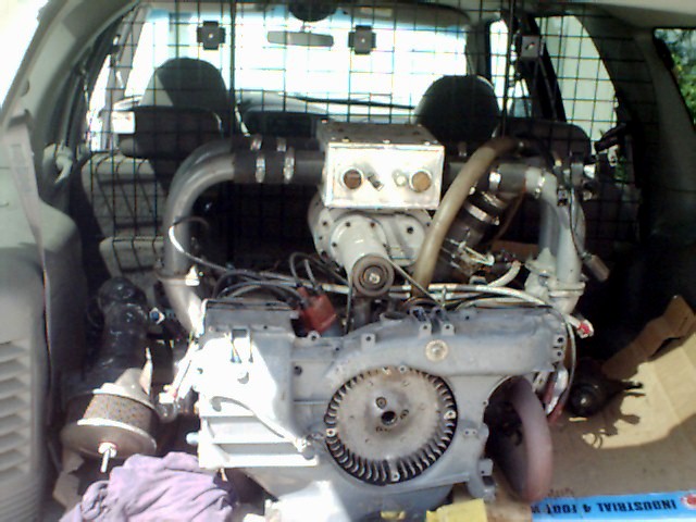

Has anyone ever built or know someone who has built a intake manafold
to install a (Ford,GM, or import) supercharger on a 914-4 or 6? (IMG:style_emoticons/default/welder.gif)

jimkelly   this guy has a supercharged type4 on his bike.   May 15 2008, 02:40 PM
Porschedub   That's cool, Jim! Thats what I want but I...   May 15 2008, 02:45 PM

PBritain   i know fat performance makes an intake manifold fo...   May 15 2008, 03:48 PM
SirAndy   well, Ferdinand himself did it, and so can you...   May 15 2008, 04:07 PM
!Wet Spot!   well, Ferdinand himself did it, and so can you...   May 15 2008, 09:03 PM
Rand   http://www.randakks.com/Randakk%20Supercharger%20F...   May 15 2008, 04:18 PM
PBritain   that setup would be E-Z to adapt to a t4 me thinks...   May 15 2008, 06:05 PM
Dr Evil   So what is this charger off of? What model, etc? ...   May 15 2008, 07:21 PM

r_towle   Look for a single carb manifold built for a four b...   May 15 2008, 08:08 PM
Porschedub   From some of the responces I have received it look...   May 16 2008, 09:58 AM
Porschedub   Hey, Rand! Who built that intake?   May 16 2008, 09:59 AM
!Wet Spot!   Sure why not? Cooling, drive belts/pulleys, and c...   May 16 2008, 10:01 AM
Porschedub   The motor is going to be mounted mid engine in a 6...   May 16 2008, 11:40 AM
Jake Raby   I have a half dozen TIV S/C builds under my belt.....   May 16 2008, 01:16 PM
Porschedub   Hi Jake! Do you have any photos of that 914 S/...   May 16 2008, 01:23 PM
Jake Raby   That sounds like my kind of build.. BUT I don...   May 16 2008, 02:05 PM
Porschedub   Hi Jake! What i'm looking for is an SC int...   May 16 2008, 04:01 PM
Jeff Bowlsby   Here are 3 S/C photos I have, I have no further de...   May 16 2008, 02:22 PM
Jeff Bowlsby   tres...   May 16 2008, 02:22 PM
JmuRiz   Why not do something like a small Rotrex style sup...   May 16 2008, 02:46 PM
