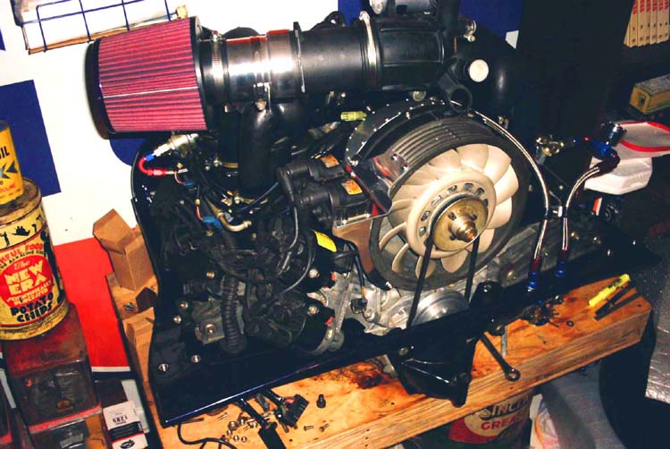

last pic is another engine shot.
Let me talk about the engine sheetmetal a minute.
There are 3 types of sheetmetal I've seen for doing a 6.
1 in fiberglass,and 2 in actual steel.I have 1 in fiberglass, and the one you see on th 3.6 is one version of the steel.
one steel version is a carbon copy replica,stamped on a press,w/all the contours,indents,notches,holes,etc.Usually sells in the $425-450 range.I've seen them from Patrick,and I think Pelican has the same thing.
I bought that mine thinking I was buying the same thing,and thought I was saving $50.00 as I'd seen these sheetmetal kits listed from several sources for around $375.00.
As many of you may know,I work in a fabshop,and I was stunned at the piece of crap I got when I rec'd my sheetmetal.
Just to let everyone know.That sheetmetal you see on ebay,look at it closely.It literally looks like someone was trying to make it from there garage using common hand tools.It's also a lot thinner than the original factory stuff.
It came in rusty.There were no holes for nothing.
I'll probably replace it in the future w/ the real repo stuff.
Word of advice is,I didn't save anything trying to save the $50.00.You'll be happier w/the better quality stuff.
Ron

East coaster   Ron, Did you flip the plenum tubes to put the inta...   Dec 31 2003, 11:04 AM
RON S.   The entire intake unit turned around 180 degrees.t...   Dec 31 2003, 11:36 AM

East coaster   Ron. Do you have any more engine pics?? I'd li...   Dec 31 2003, 07:23 PM
Brad Roberts   From his pic.. it appears he flipped the center se...   Jan 1 2004, 03:16 AM
Brad Roberts   Here it is with the intake off but the bases still...   Jan 1 2004, 03:17 AM
seanery   ...nice sock :lol:   Jan 1 2004, 07:26 AM
East coaster   Brad, Yeah....mine looks the same. I was planning ...   Jan 1 2004, 09:09 AM
