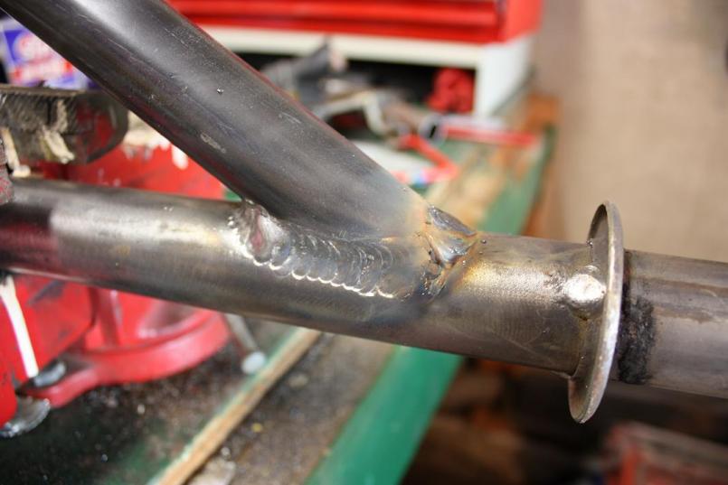

this was probably the best weld of the bunch
also, id like to thank Bob Kikascik of Stable energies for donating parts to this project

i love porsche   this was probably the best weld of the bunch al...   May 20 2008, 12:11 PM
rick 918-S   Welding is only learned by practicing...alot! ...   May 21 2008, 07:24 AM
type11969   Did the torsion tubes warp at all when welding the...   May 21 2008, 08:22 AM
Spoke   Nice work. I agree with you about the ball joints....   May 21 2008, 12:02 PM
i love porsche   thanks for that link chris, ill have to give him a...   May 21 2008, 01:27 PM
jd74914   Looks good Aaron. Worst case with the warpage yo...   May 21 2008, 07:19 PM
