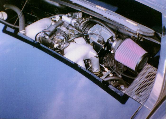

Thought I'd post a few pics of my continuing (what seems like a life long project.)
Pic 1 is of the front corner,I finally got around to painting the Getty Design hood on the front that I bought last Aug.
This past weekend,after the paint had set on it about a month,I color sanded it and buffed it out.
I spent 4 hours sanding & buffing on the hood alone.
Sorry about the dark pic it was taken late in the day.
If ya look towards the cowl area of the pics,you can see the ridge beam of my carport,It's 12 feet up from the floor.

Ron. Do you have any more engine pics?? I'd like to see some up close shots of cooling tin, especially around the distributors. I have two sets of sheet metal kits, one steel and one fibreglass. Haven't really decided which to use yet. I figured FG I can add/delete and keep it looking stock and steel will have to be patched in some places which will take a little more work to look "stock". I'm leaning toward the steel though.
When you said you rotated the whole manifold, you mean you loosened the 6 coupler hoses and pulled both plenums and center section as one piece and rotated it? The only other 3.6 I've seen flipped looked like they only flipped the center section.

East coaster   Ron, Did you flip the plenum tubes to put the inta...   Dec 31 2003, 11:04 AM
RON S.   The entire intake unit turned around 180 degrees.t...   Dec 31 2003, 11:36 AM

East coaster   Ron. Do you have any more engine pics?? I'd li...   Dec 31 2003, 07:23 PM
Brad Roberts   From his pic.. it appears he flipped the center se...   Jan 1 2004, 03:16 AM
Brad Roberts   Here it is with the intake off but the bases still...   Jan 1 2004, 03:17 AM

East coaster   Brad, Yeah....mine looks the same. I was planning ...   Jan 1 2004, 09:09 AM
