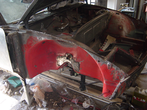

After a lot of work I finally primed the interior compartment today.
I stripped off the paint
Installed Engman's long stiffener kit,
Redid the speaker hole patch in the fire wall
Made a hand throttle
This is the speaker hole patch before and after

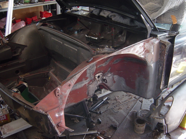

Ok guys here is some more.
On to the front where I install a sway bar with Enmans swaybar supports. I then added some more weld to the front panel and wheel house because I replaced those years ago after a accident. I removed the fenders because the doors gaps were to wide and it made it a little easier to work on. They came off easy because I braised
them on before.

craig downs   Ok guys here is some more. On to the front where I...   May 26 2008, 12:02 AM
craig downs   I had to remove the head light box because when I ...   May 26 2008, 12:03 AM
craig downs   With the fenders install   May 26 2008, 12:11 AM
craig downs   I thought it would be a good idea to check and mak...   May 26 2008, 12:24 AM
craig downs   Hear it is done along with the drivers side.   May 26 2008, 12:27 AM
