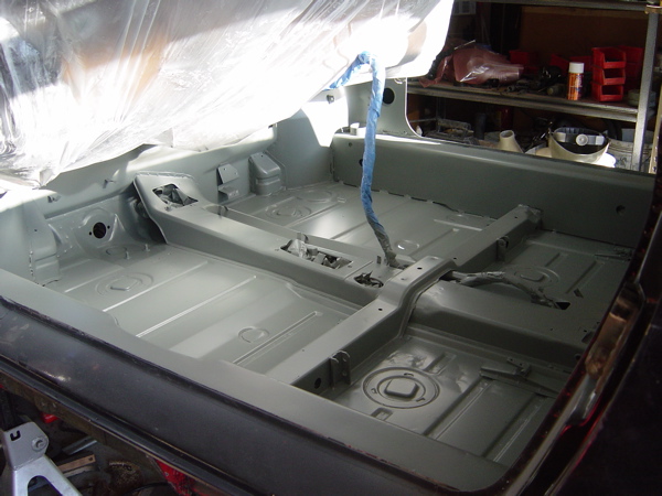

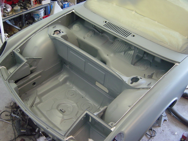

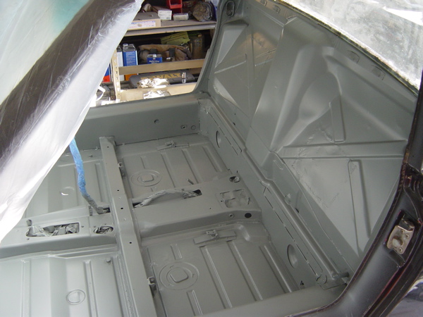

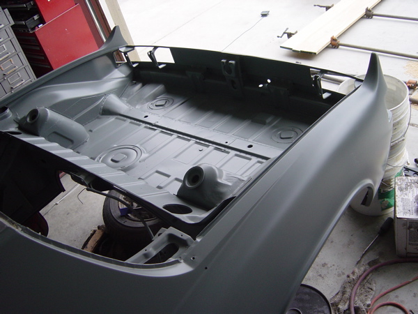

After a lot of work I finally primed the interior compartment today.
I stripped off the paint
Installed Engman's long stiffener kit,

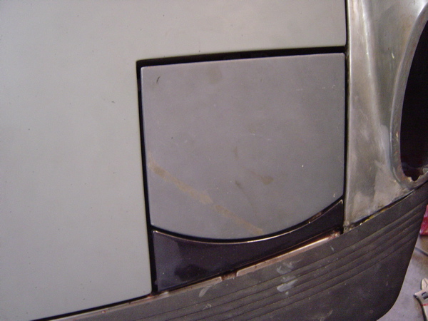

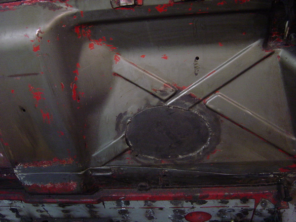

Redid the speaker hole patch in the fire wall
Made a hand throttle
This is the speaker hole patch before and after

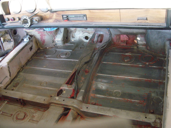

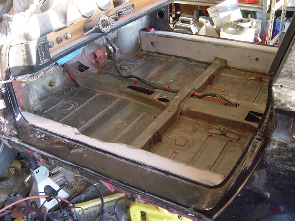

craig downs
Paint srtipped and cleaned
craig downs
And Primed
craig downs

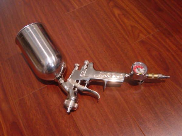

I just bought this new spray gun last week its a Devilbiss Plus. I've always like the
the old school guns with a pressure pot but this new gun is awesome. The delivery
is much like my older ones but atomizes so much better.

nice repair Criag - I'm so glad that you replaced that speaker hole with a proper patch. smile.gif

I used PPG DP40 epoxy primer and had good luck with. I'm planning on using a primer surfacer over it then block sanding it then a sealer before the top coat.
You have to make sure that all the primer you use is compatible with each other and
your top coat.

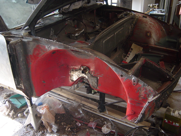

Ok guys here is some more.

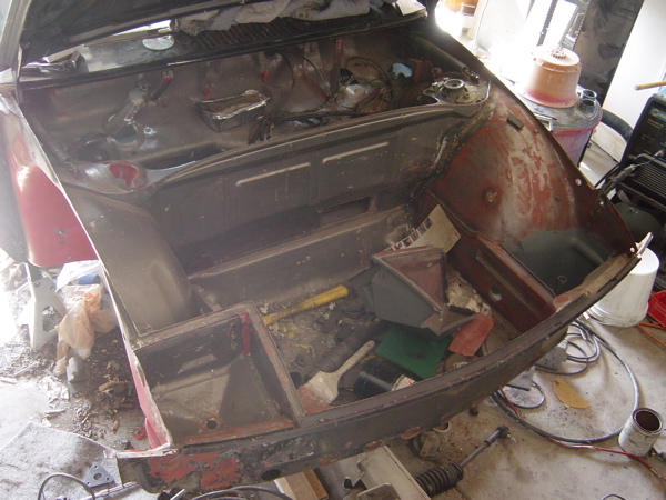

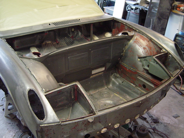

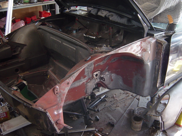

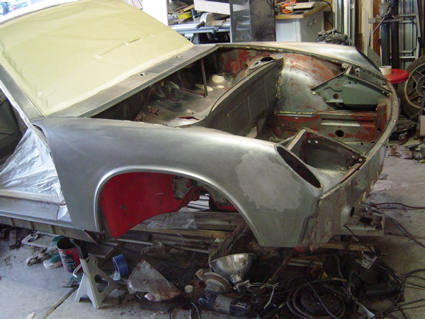

On to the front where I install a sway bar with Enmans swaybar supports. I then added some more weld to the front panel and wheel house because I replaced those years ago after a accident. I removed the fenders because the doors gaps were to wide and it made it a little easier to work on. They came off easy because I braised
them on before.
craig downs
I had to remove the head light box because when I put it in before it rubbed with the corner of the hood.
As it turn out it was to wide so I had to shorten it and now its just right

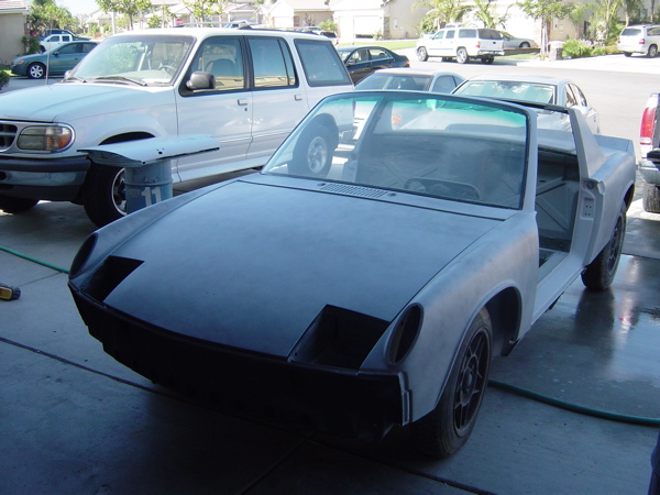

With the fenders install
craig downs

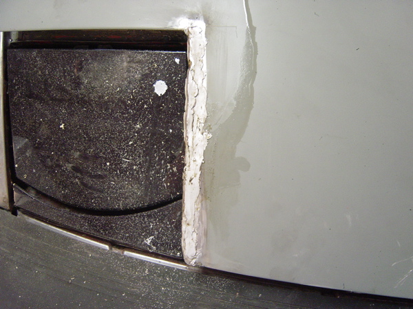

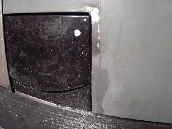

I thought it would be a good idea to check and make sure everything lined up with the hood, headlight doors and ebrows, and the fenders before I finalized everything. As it turned out everything looked good except the hood gap on the passenger side headlight door. So I added to the hood with some lead. Sorry I started taking pics after I had the lead on.
craig downs
Hear it is done along with the drivers side.

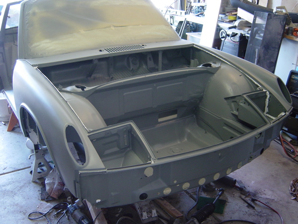

Ok I've been bad about updating my progress its been awhile but its coming along pretty good. So here is the front end primed with PPG DP 40.

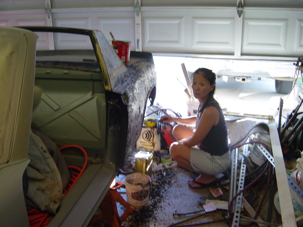

My wife came out and said I'm board is there anything I can do.
So I said hmm do you want to strip some paint and she said ok.

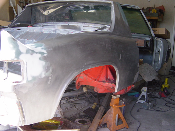

craig downs

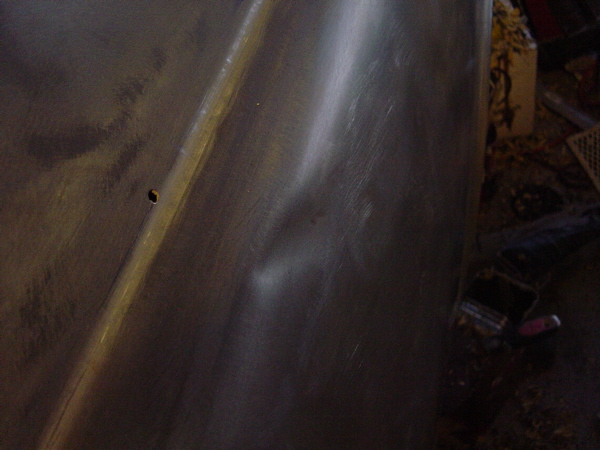

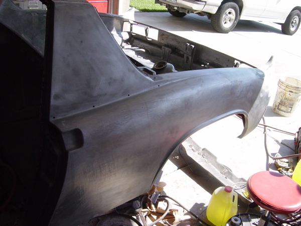

I was painting a wine rack for work and when I closed the garage door it pushed it over and fell on the car and made a dent but I was able to metal finish it without to much trouble.
craig downs

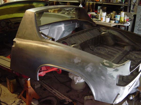

This is how I chose to do the spoiler. I cut off the ends and mounted them on the rear fenders. I mixed up some fiberglass resin and took some mat and shredded it and
mixed it in with the resin used it to blend it into the lid. You have to make sure you get all the air pockets out of the resin or you could have trouble later on. Then I used body filler with fiberglass strands to finish it.
craig downs
Here is how the ends look like.

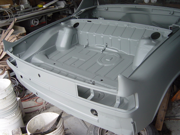

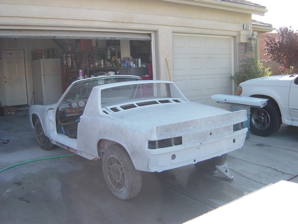

Rear end ready for 1st coat of primer
craig downs
Rear end primed with epoxy primed
craig downs
Next I sprayed some primer surfacer and a guide coat to aid with sanding
craig downs

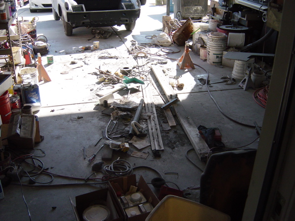

I put the suspension back on the car so I can push it in and out of the garage while wet sanding and painting. After over a year on jack stands here is the mess that was created.
Boy what a mess.

Craig: My car has been on the stands so long that I done major cleaning under it 4 times.
