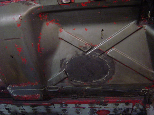

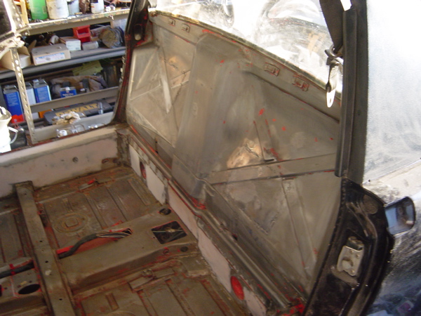

After a lot of work I finally primed the interior compartment today.
I stripped off the paint
Installed Engman's long stiffener kit,
Redid the speaker hole patch in the fire wall
Made a hand throttle
This is the speaker hole patch before and after
craig downs   Progress   Jan 20 2008, 06:13 PM
craig downs   Paint srtipped and cleaned   Jan 20 2008, 06:18 PM
craig downs   And Primed   Jan 20 2008, 06:20 PM
