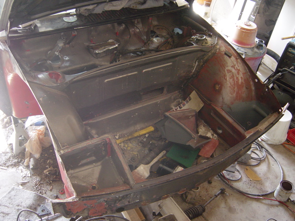

After a lot of work I finally primed the interior compartment today.
I stripped off the paint
Installed Engman's long stiffener kit,
Redid the speaker hole patch in the fire wall
Made a hand throttle
This is the speaker hole patch before and after

I had to remove the head light box because when I put it in before it rubbed with the corner of the hood.
As it turn out it was to wide so I had to shorten it and now its just right
