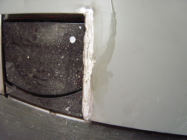

I thought it would be a good idea to check and make sure everything lined up with the hood, headlight doors and ebrows, and the fenders before I finalized everything. As it turned out everything looked good except the hood gap on the passenger side headlight door. So I added to the hood with some lead. Sorry I started taking pics after I had the lead on.

craig downs   I thought it would be a good idea to check and mak...   May 26 2008, 12:24 AM
craig downs   Hear it is done along with the drivers side.   May 26 2008, 12:27 AM
craig downs   Thanks Steve for the tip about using foil. I never...   May 26 2008, 12:30 AM
