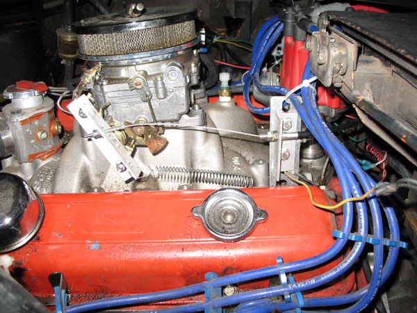

jimkelly   throttle cables - what are you guys using - stock ...   May 29 2008, 04:57 PM
marks914   Here is mine, an extended terry cable, it came wit...   May 29 2008, 05:15 PM
cobra94563   I currently using the STOCK throttle cable pulling...   May 29 2008, 07:11 PM

BIGKAT_83   The stock cable works fine if mounted correct. I d...   May 30 2008, 02:05 PM

TC 914-8   Lots of great pictures, I have a Rod Simpsin kit a...   Jun 11 2008, 01:18 AM
TC 914-8   I re-ran the factory cable from two tight turns in...   Jun 11 2008, 01:31 AM
computers4kids   I re-ran the factory cable from two tight turns i...   Jun 11 2008, 08:33 AM

jimkelly   got a custom cable from terry cable - 18 inches lo...   Jun 12 2008, 03:20 PM
