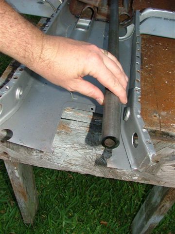

Building the armageddon proof clutch tube!!!
I have heard too many horror stories of people's clutch tubes failing while
far from home so I decided to go big on my replacement tube.
Ok, so that was a joke. (IMG:style_emoticons/default/biggrin.gif) (IMG:style_emoticons/default/biggrin.gif) (IMG:style_emoticons/default/biggrin.gif) McMaster kind of overdid it on the tube size
that I ordered. This one looks like a good barrel for my 75 caliber sniper rifle
project. (IMG:style_emoticons/default/idea.gif)

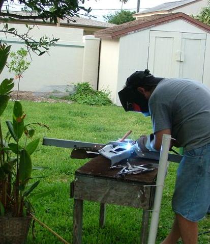

After getting the correct tube sizes, I started piecing the tunnel together. I had
a good rear section from another board member and I welded it to what is left
of my front section.
