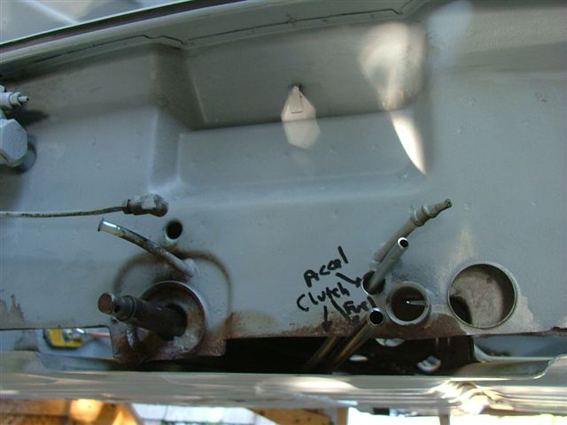

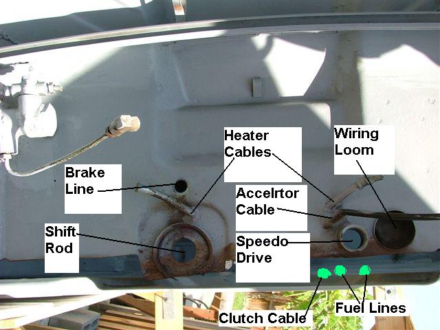

Took me a while to figure out what tubes and cables came out where in
the engine bay. This is what I came up with.

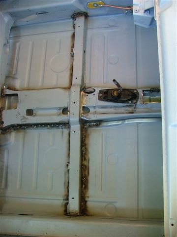

The bottom of my outer fire wall was rusted to nothing adding to the
confusion. After test fitting the tunnel plus clutch, accelerator and
shift rod, it looked like this.

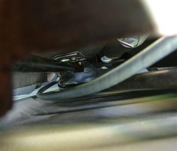

Then I checked to make sure the shift rod did not contact the tubes in
any of the gear positions. I also did not fit the heater tubes at this time
because I am using a tangerine header system without heat exchangers.
This is a view up the tunnel from the engine bay. The shift rod is in the
upper left and the tubes for the clutch and accelerator curve across
the bottom.
When I was convinced it all fit right, I mostly welded the tunnel in. This
feels like a big milestone for some reason, many more to go.
