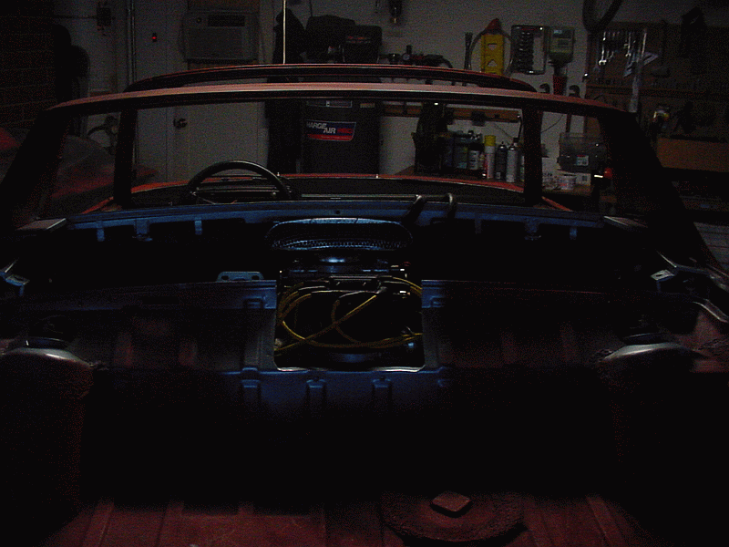

Well, I came home tonight after work and felt like turning a wrench so I headed for the garage. I went ahead and bolted a sideshifter up to the chevy v-8. I was glad to see once I had pulled the tailshifter which was on there, I saw the a new 9 inch two stage Sachs clutch...yes, the PO had purchased the upgrade clutch package.
Things were moving along, so I figured I would try to see how the motor was going to fit. That was easier than installing a 4! I feel like I'm making progress...the motor is now bolted in place and clearances are good...by pulleys, sides, and the lid will close. I will have to cut the brace on the lid. Anyway, that's enough for today.
Oh...I did notice that the housing that bolts to the water pump was not tight and on closer inspection was just loosely attached with no gasket. Will I find that gasket at FLAPS?...or do I need to source it from Renegade. I guess I could make one as well.

The gasket should be a Fel-Pro 11730
