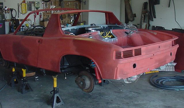

Edited.....thought I would add some before and a after picture since this thread has evolved into a v-8 install/restore/modify thread. The story begins....

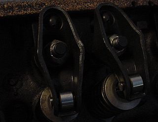

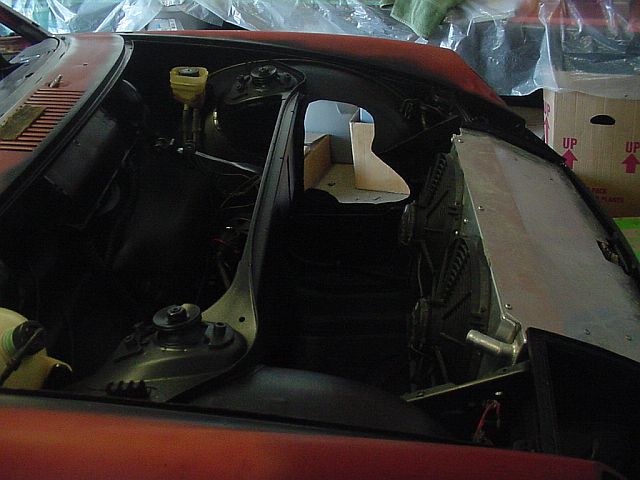

More progress...installed exhaust, prepped the front trunk and installed the radiator. I pulled the valve cover for fun to take a peek...brand new built 305 with roller rockers to boot. Today, I hope to run the coolant lines and reinstall the gas tank.

computers4kids   radiator lines & front trunk compartment (gas ...   Jun 2 2008, 12:46 AM

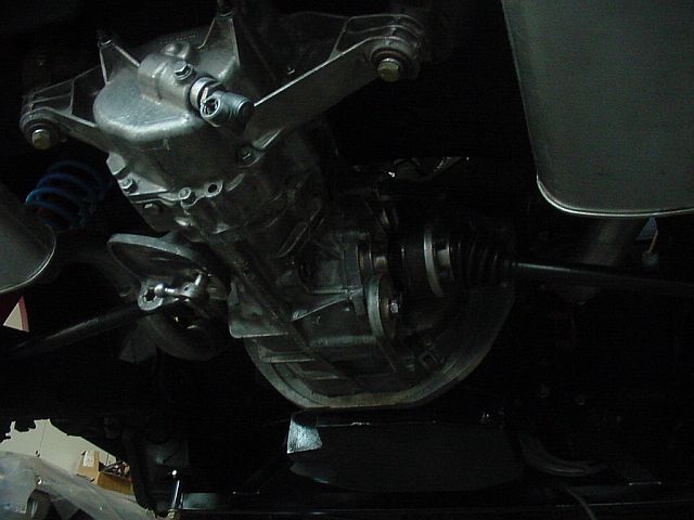

computers4kids   The car can now be timed from the driver's whe...   Jun 22 2008, 02:39 PM
